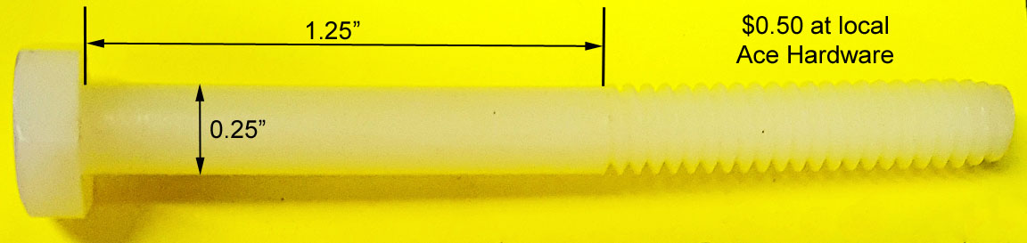

As Bob said, those are "shear pins" and meant to break when stressed. There is nothing special about these shear pins. They can be replaced by plastic bolts purchased at Ace Hardware.
Here is a picture of one I have used. You can cut it where the threads start if you wish.

Hobie SKU 8032081 SCREW 1/4-20 X 1-1/4 CAP SCREW
We also drill them for using a ring rather than a nut.

BTW, I recommend you drill out the hole in each bolt, to fit a small zip-tie. This is MUCH easier to use than juggling your wet fingers with a nut to secure the new bolt.
