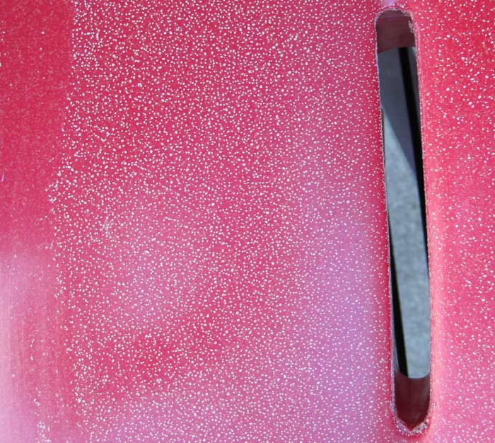

Though I know better, I left our boats in the water from Sunday morning through Friday evening. This is not sand. Those are all baby barnacles on my wife's boat. They scrub right off at this size, but you can't hose them off.

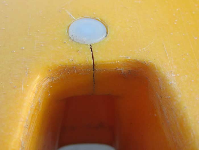

In the course of cleaning my boat, I noticed this.
Uh oh! :shock: It's pretty dirty in that crack, so I guess it has been this way for a while. I haven't noticed it, but then, I never look at the bottoms of our boats. They live on the trailer.
So what do I do about this?

That's the notorious front drivewell crack Tom.
I'm surprised you haven't noticed any water inside the hull. :?
It should be covered under warranty. I had a similar problem on my 08 AI and Hobie promptly replaced the hull. :)
See your dealer.

I did not know this was a warranty situation. Other than letting that one Sasquatch play with it, I have been careful with the boat and did not do anything I know about to cause this, but I just figured boats crack. I was thinking of taking my Bernzo torch to it, but if Hobie warranty policy is to replace the hull, I won't bother. Would that even work?

I kept using mine until the new hull arrived. Pedaling causes the crack to open so if you sail with the drive out it shouldn't be too much of a problem. Just make sure you take a bailer. :wink:
It appears that this is an occasional roto-molding problem- (we don't have Sasquatch's down under...only Yowies and I've never let any near my boat :lol: ) Once my dealer sent the pics Hobie Aus warrantied it without question.

Likely there is plenty of solid material in front of the area that is not allowing water into the hull.

This would certainly be covered. Regardless of it not currently leaking... the crack is a concern.

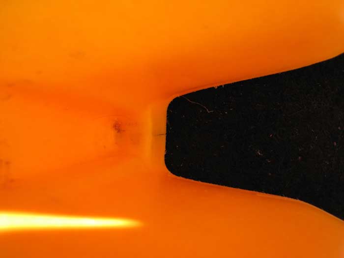

I went down and picked up my replacement hull today. Before I left, I took a picture from the top of the crack in the well. It's easy to see from this perspective why it did not leak, and why I did not ever notice it.
