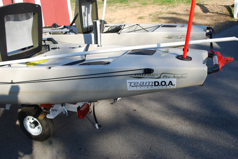

Here are some pics which may help. My time with college lately has let me out of the game, I will be back come spring....college or no college. Email me direct if you need help, since I'm rarely here...wish I simply had more time. [email protected] . MJ.

Nice pictures of the anchor trolley installed.
can I ask you what kind of trailer you are using to transport the PA?
