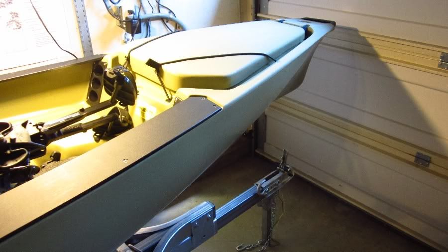

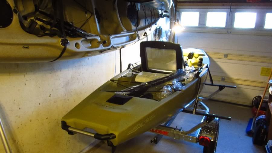

In my little garage with Malone XT tongue retracted:
For now 2" sch 80 conduit. I just need a better way to attach to bars.

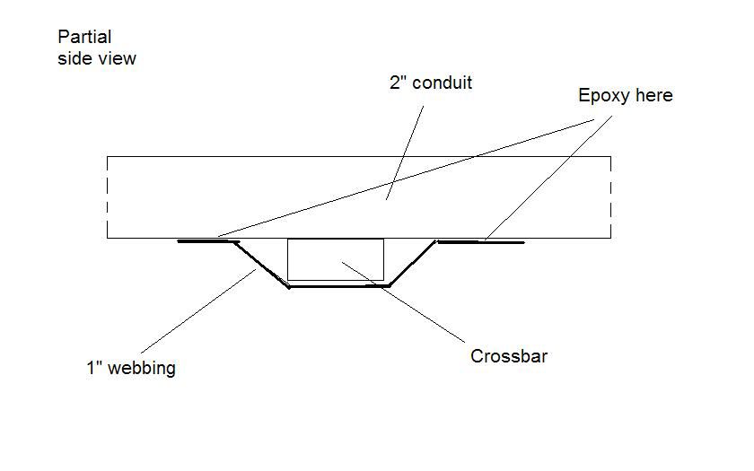

Okay...a better way to attach the PVC pipe mounts to the crossbars occurred to me this morning.
Here is what I originally did:
Used two 7 foot sections of 2" diameter schedule 80 PVC electrical conduit pipe. I drilled holes on both sides of the pipe where they sat on top of the crossbars then fished a large zip-tie through the holes and around the crossbar. I don't care for this due to the fact that drilling the holes weakens the pipe a bit and zip-ties can break.
I will add here that after the PA is loaded, the sheer weight of the boat holds the pipes within it's scupper line. The main point of holding the pipes in place is during loading and unloading. I never got them tight to the crossbars and that is a good thing considering you want the pipes to move laterally as they find and follow the scupper groove line.
Here is possibly a better way:
Using the same type/size pipe I would glue a slippery yet soft indoor/outdoor carpet just over the top half of the pipe (I glued some to 4" drain pipe in an earlier post but the height of the kayak was going to be unmanageable in my opinion).
Now, instead of drilling the pipe cut four appropriate short strips of 1" webbing tie-down strap material and epoxy one end to the underside of the pipe, go around the crossbar, and then epoxy the other side.
Improve on this as I am sure it can be done but this would allow for them to stay put during loading and unloading while providing a more secure mount option. They could still slide to follow the scupper line yet I feel not relying on zip-ties and holes would be a big peace of mind.

Why not put the tie down strap material over the pipe, epoxy it, wrap around your bar and bring it back up and epoxy again. Then put the carpet over it. That would give extra hold on the strap I think?
Are you sure the epoxy will hold the strap?

Since the PA is so darn heavy I wanted the smoothest surface possible so as not to create indentations in the hull. I also store my PA on the trailer.
A good two part epoxy I am sure will hold plus the straps are not really holding anything except pipe movement during the on and offloading process.
Some of my thinking behind it.
Thanks for the added suggestion!

I will be storing mine on the trailer too. I like the idea of being able to move in case I ever add another kayak and really like the idea of not drilling the pipe. I guess I don't know the strength of epoxy. Would it make sense to run several inches longer on the pipes then epoxy a couple cross strips over your strip and about halfway up the pipe for added security? I guess I am thinking of the stress on the front cross bar as you have the PA loading on or off the back end.
Thanks for the idea. Let me know how it works.
