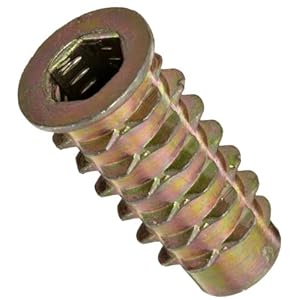

I have had very good luck with stainless sheet metal type screws driven into a very small starter hole. And the screw in threaded inserts made for wood really hold because they go into an 11/32 hole and really have a large surface area holding into the plastic. They are inserted with an allen wrench. Just put the insert on the allen wrench and then push hard as you start the insert. Try to keep it at a perfect right angle. The initial threads will grab and then the insert threads follow the initial groove until the small head is seated. The sort shown in the picture with a nice head will bury just right in the plastic. Just put a dab of sealer under the piece being fastened and under the head of the screw.
