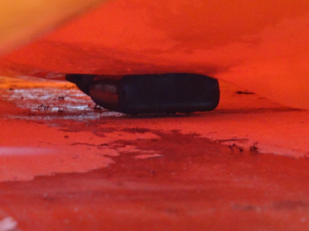

I can't help you with the Lowrance fittings, but I've mounted my HB sidescan transducer where the Lowrance Ready mounts is, underneath the hull. It's permanently mounted there.
Here are some pics of the mount I made to give you some ideas. The material is 3mm aluminium plate and 2mm x 40x40mm aluminium angle. The protective blob of material in front of the transducer is epoxy resin putty.
This one shows the setup from above.
A side view of the bracket
Now fitted to the hull in place of the plastic hull mount supplied by Hobie.
The view from the rear of the hull with the yak resting on flat ground.

There's no need to make the plate, do the same thing your doing but to the plastic cover. Slightly recess the transducer into the cover from the outside, basically insert the cable and mounting area by cutting the cover than build it up with marine goop both from the outside and inside. Make sure that the transducer beam clears the hull on both sides. The transducer can take a beating so don't worry about damaging it. There is a photo in this forum of what your looking for.

I'm sure the transducer can take a beating. It's the original plate (after being cut) that I thought would cop a hiding.
I also wanted a protective blob in front of the transducer to prevent it being knocked up and out of alignment and to prevent weed catching it. Epoxy won't stick to PE, but there may have been something else I could have used.

http://bassyaks.com/wp-content/uploads/2014/02/20140222_132708-800x600.jpg
Use marine goop
layer it on and it will never move

SteveK wrote:
This looks sweet. Do you have any pictures of the plastic plate before you gooped the transducer
