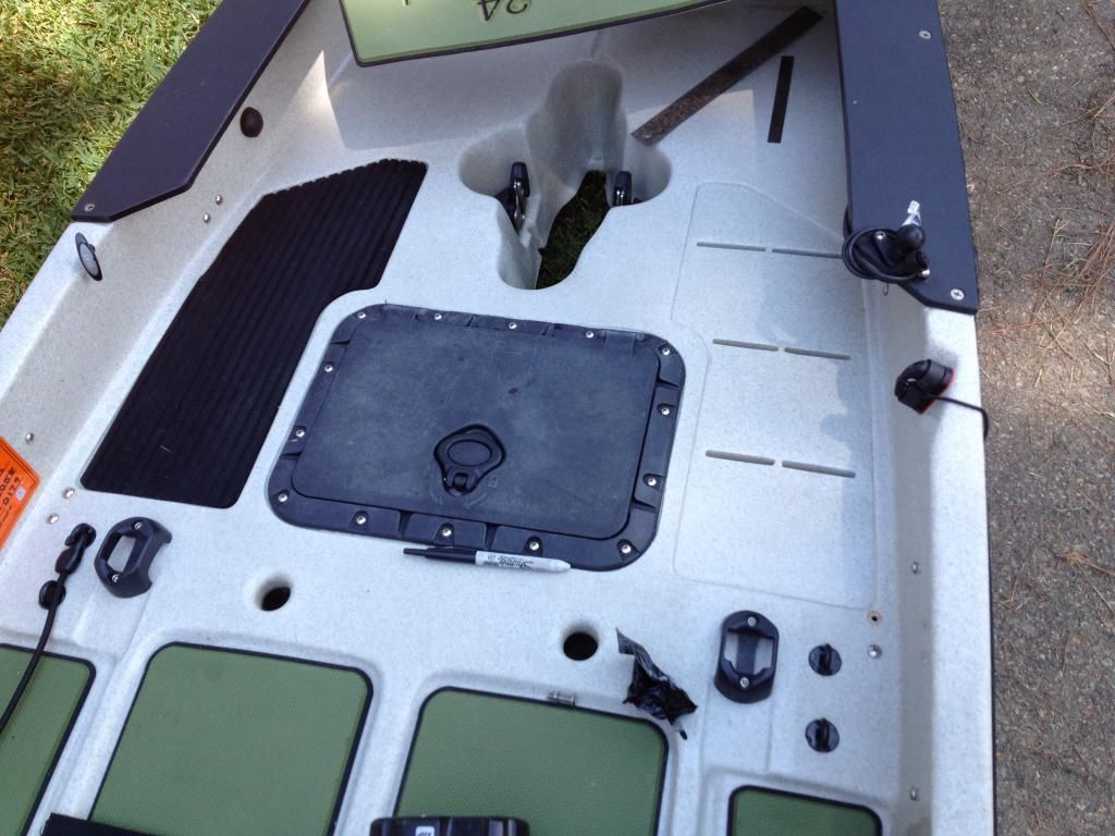

Then I used the piece of Hydro-turf as a pattern to cut out 1/8" thick lexan into the proper shape for the recessed area.

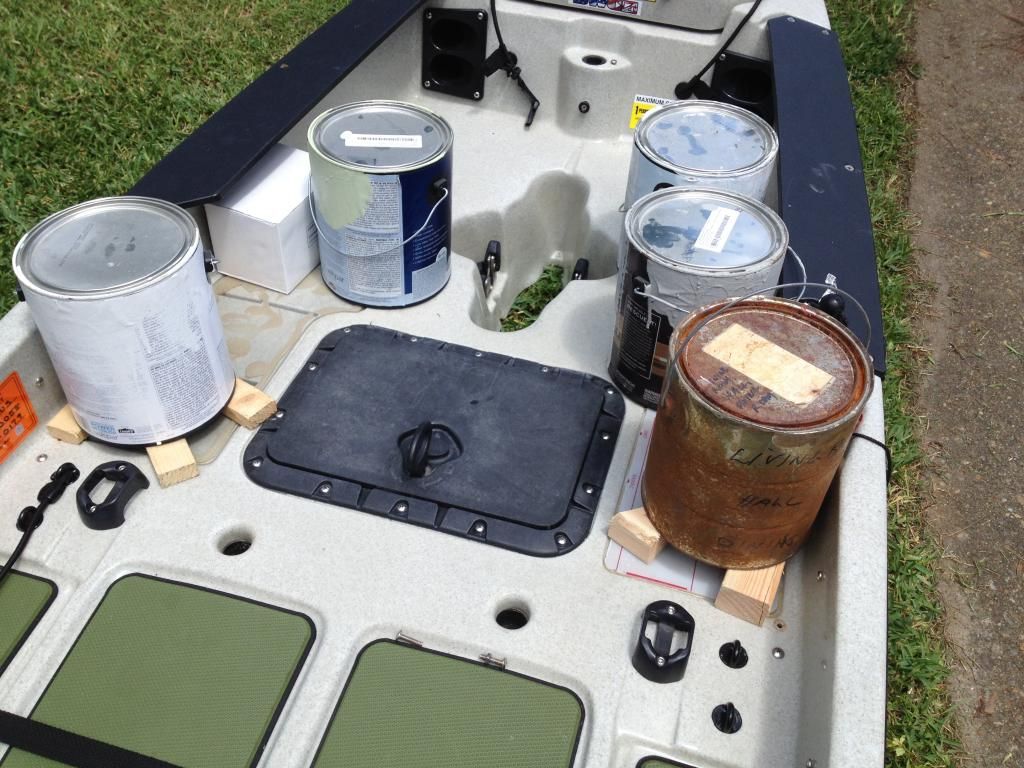

Next I roughed up both surfaces with sandpaper for better adhesion and then glued the lexan to the kayak with Locktite PL Premium construction adhesive. That stuff will glue a used car salesman to tefflon! Then I used some pieces of wood and old paint cans to hold the lexan in place until it cured for 24 hours.
The front deck area is now 'leveled up'.

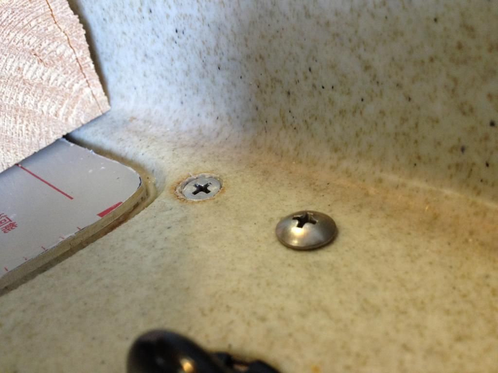

Since the Oceangrip will have some of the hardware so near it's edge, I decided to flush mount some of the hardware to prevent the possibility of it peeling up over time. I used a countersink drillbit for wood and only used my fingers to gut into the kayak. **Using a drill is unnecessary and you will very likely take out to much material!** I replaced the screw with a quality stainless steel one.
