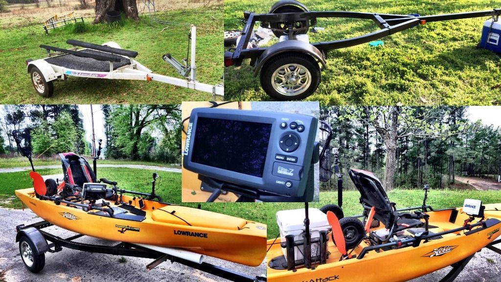

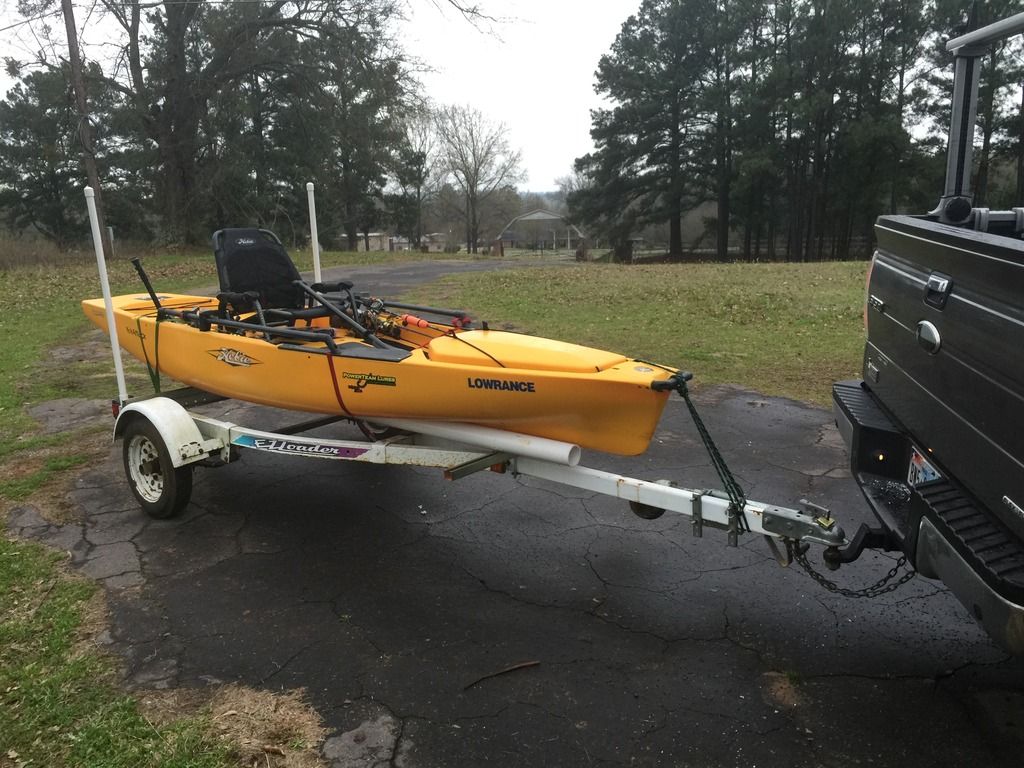

Got the trailer built with great help and info from several post once I got the search figured out. I'm having with the spacing of the pvc falling in line with the scupper channel. I used 3" pvc spaced 10", 10.5", and 11" off center in the rear and a tad bit narrower in the front. The front is great but the rear I'm questioning. Maybe I'm just parinoid... I thought about using lock nuts and loosen them up a bit so the pvc has more freedom, but I figured that might not be wise. Anyone have pics of the pvc siting in the scupper hole channel? until then time to role.
Trailer tongue will be lengthen,basket in the front to hold yeti, removable uprights and rack to hold another kayak, larger fenders for the mag 13" wheels, sandblasting and paint. I may weld on tabs to carry my bike on one side and narrow long tool box on the other.

Well I finished up the second part of the trailer yesterday. Gave it a facelift:
Hubs
Studs
Bearings
Adjusted pvc
Some grinding
3 coats of paint
Wheels
Tires
I plan on adding uprights and a rack on top like @Ring King trailer. I will then add on a roof top tent.... Or I may add it to my Thule truck racks.
I also rigged the PA yesterday with just a few little things:
Elite 7 chirp
Yakattack panfish/ dog bone
Two gopro hero 3 black with battery eliminator (12 hours of 1080 60fps recording from both)
Yeti roadie 20
