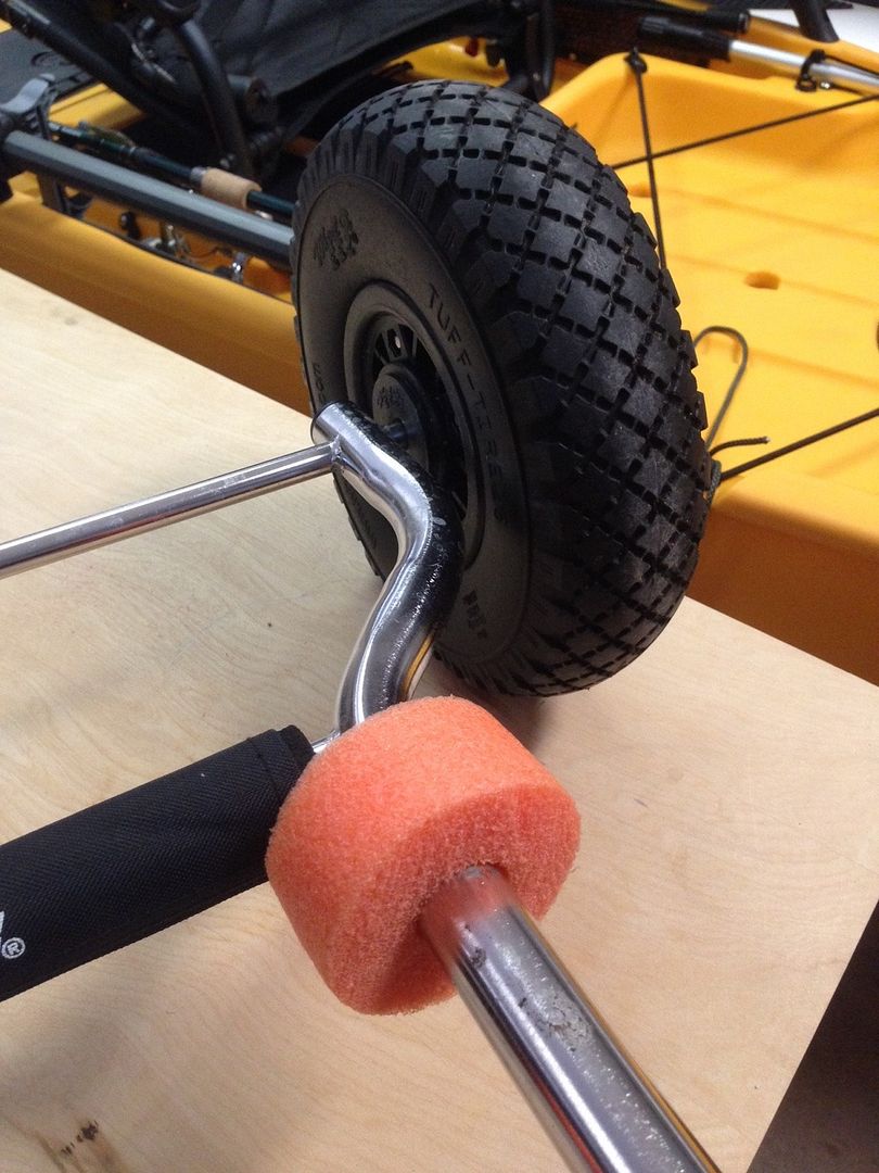

I decided not to use the hard stoppers. With the hot summer temps where I live I didn't like having a hard point of contact on the hull. I used a 3 inch foam pool noodle and cut two pieces 1 3/4 inch thick. They fit nicely over the cart poles. They compress and form around the scupper hole and distribute the weight more evenly. I found that 1 3/4 inch gives just enough compression that the majority of weight is on the foam and just a little support weight is on the crossbar (not enough to damage or dent). Anything thicker than two inches and the posts don't stick up high enough through the top of scupper hole on my 2015 PA12.

Great idea Cory!
