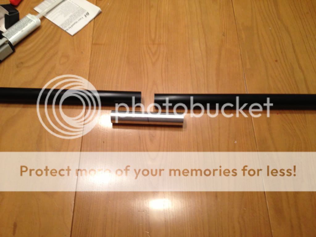

After several outings, I decided to add Sidekickers and a trolling motor to one of my PA14. i am a big man @ 350lbs, and while the PA is extremely stable, I have noticed it to be a little tipsy when I have the seat in the elevated position. I just want a little insurance that I won't be going for an unintentional swim with a wrong reach or move.
The Sidekicker kit is NOT designed for the width of the PA. I ordered an additional mount tube and cut both tubes down and joined them in the center to make one long tube. Luckily I work in a machine shop and had my guys make me a 6" long aluminum joiner piece to slide into the tubes, that I epoxied in place, making one long tube. It's too bad Hobie doesn't offer a kit with a long tube for the PA.
I used Loctite Hysol epoxy to join the tubes. It s very strong stuff.
I mounted them just behind the seat. The mounting brackets fit just right up under the side handles. I did need to remove the rear handle bracket and tube to mount the Sidekick brackets. Then put handle back in place.

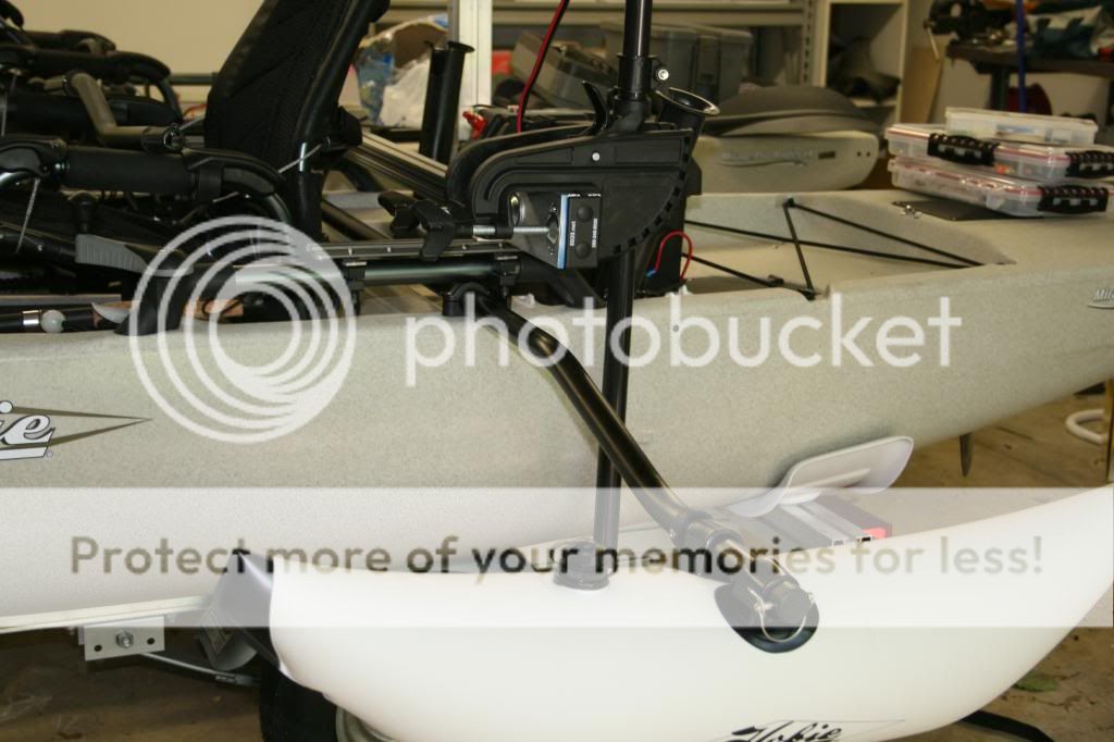

My trolling motor mount:
I looked at several options. I even built one of Tom's simple PVC mounts, but decided it was just a bit to flexible for me. There was way to much flexing movement in everything for me to be comfortable with it. The Minnkota 38lb transom mount motor is quite a bit heavier than I expected and I think that s why the PVC seemed so flexible.
What I ended up with wasn't the simplest or cheapest, but I think it looks good and is very strong.
I started by mounting 8" Yak Attack Geartrac on each of the side handles. After some trial and error in the location, I found the needed to be far to the rear of the handles, so the cross bar I was to add didn't hit the seat.
I used 1-1/2" 80/20 brand aluminum extrusions for my cross bar and mount. I ordered a 48" piece from McMaster Car, then cut a 6" piece off of it to use as the doubler to mount the motor on.
I also got a 3" wide x 1/4" piece of aluminum to put on the face of the doubled up extrusions for the motors camp screws to tighten against.
After I get a chance to set the height in the water, I may shorten the shaft ad possibly remove the head and make up a control box within easy reach from the seat.

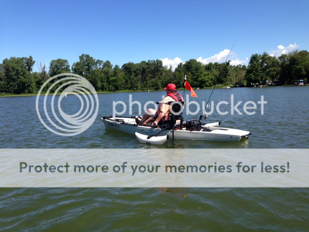

Got a chance to try ut the Sidekicks and Trolling Motor today. Both worked really well. I was on a very flat inland lake, but very happy with both.
The Sidekicks made a huge difference, I was able to lean and reach over the side without feeling like I was on the edge of going over.
The trolling motor worked well. It took a bit of getting use to the motor thrust on the left side. Boat turns pretty hard to the right upon startup. Once moving its not bad. Turning the motor slightly toward the boat makes a big difference.
