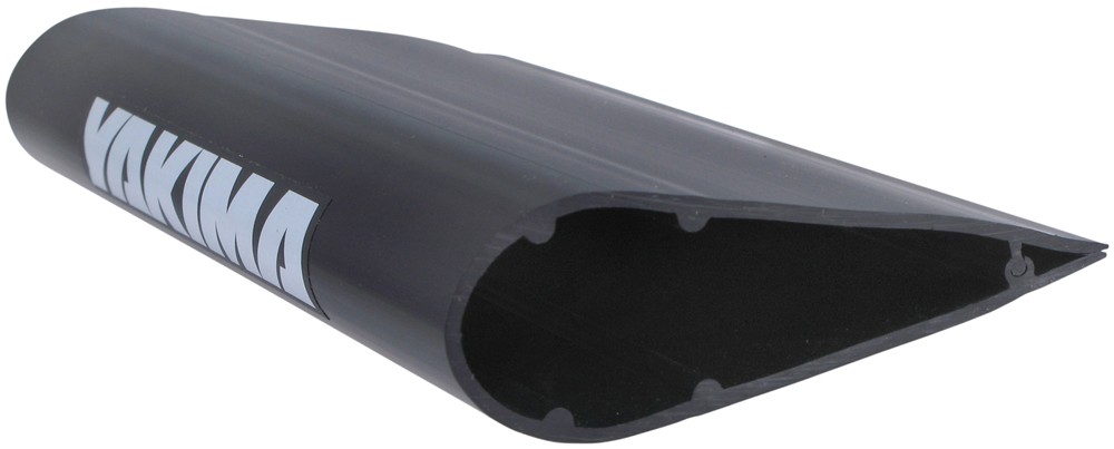

I wish Torqeedo would put some type of cowling or something on the leg of the 403 right above the motor. The round leg on the 403 starts blowing a hole in the water behind it once it hits around 4mph allowing the prop to drag air down it and in to the prop making a slurping/gurgling sound ..( Its called cavitating).. Like a blender...and i'm sure that is a performance robber as well....something like the Travel leg would be ideal and it wouldn't even have to go all the way up the leg! Just the portion of the leg in front of the prop should do it...
PostPosted: Mon Dec 21, 2015 1:08 pm
You can probably make yourself an anti-cavitation plate with some white cutting board material (walmart), a drill and hack saw. Just drill a hole slightly larger than the shaft and hold in position with a wrap of duct tape above and below the plate.
Just an idea
FE
PostPosted: Mon Dec 21, 2015 4:07 pm
Joined: Tue Nov 11, 2014 10:51 am
Posts: 263
Thats a good idea i was pondering already but after discovering a couple of huge cottonwood leaves wrapping around the leg in front of the prop cured the problem i am leaning towards making something to change the shape on the aft side of the shaft. The round front doesn't hurt...its the round back once you reach 4mph and above. Needs to be tapered behind like a teardrop....

I put one of these 'Yakima Windjammer's around mine...
It doesn't exactly fit but 2 small bolts did the trick. It seems to work. :)
https://www.etrailer.com/Accessories-an ... 01115.html
PostPosted: Mon Dec 21, 2015 4:12 pm
Posts: 263
Now you have the idea i was thinking about right there....You put this on the 403 ? Could you explain the fit not being right ? I'm guessing to small and you had to pull the ends together with screws or small bolts ?
PostPosted: Mon Dec 21, 2015 4:19 pm
Joined: Wed Jul 25, 2012 1:53 pm
Posts: 50
Location: Chicago
Exactly right... The back end would not snap in place so well because the bar is just a bit too big.
I just took 2 stainless bolts and drilled holes near the back trailing edge... thew in some washers and i was able to tighten down pretty good. You can still slide the plastic piece up and down but it seems to stay in place okay.
I wish the 'Windjammer' was a bit longer but so far I think it helps...
The 'Yakama' sticker on mine peeled right off... so it looks good too.
It was about a 5 minute project once the part arrived.
Thanks! I will keep this in mind. I was thinking about making one out of a plastic/nylon folder as well but you nailed it ! I'm guessing the cavitating stopped? Did you notice any performance gain up there? I did when those big leafs wrapped around mine. Not a lot but it was there...

This is just a quick throw down but you get the picture....a little 2 sided tape and fill the back void with some tuff stuff spray in foam and you're in business. ...and dont forget the Realtree Xtra camo :mrgreen:
