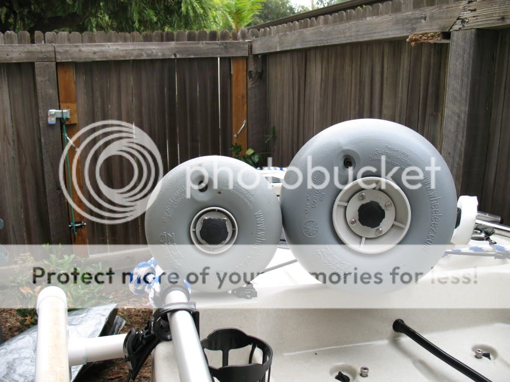

Sorry I took so long to get back at you. Here are some pics of the cart and WheelEez so you can see the difference between 24cm WheelEez and 30cm WheelEez.

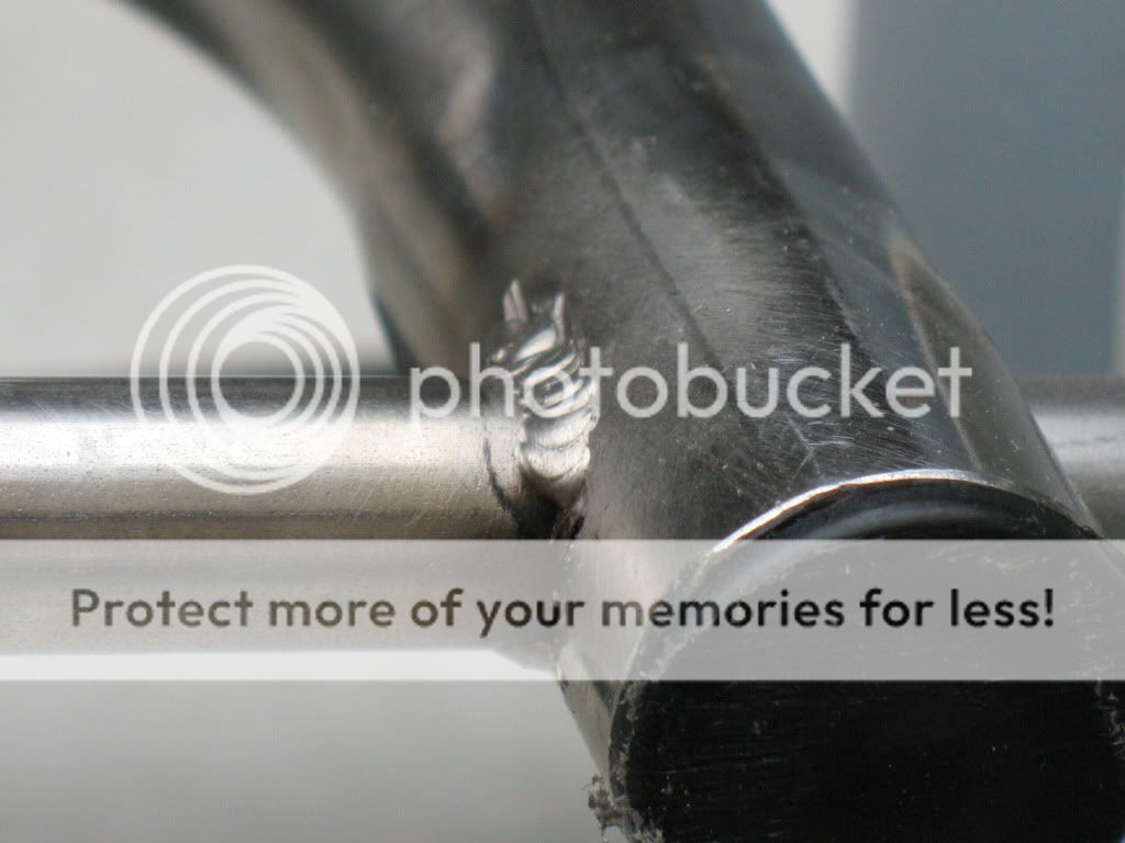

This is the weld to cut (on each side of axle)
Finished Product
If you are in the habit of plugging the cart in upside down in rear scupper holes while on the water this mod will cover/block access to built in rod holders in hull. You can always remove WheelEez from cart and strap them down separately. Other than that there are no problems. I love it!
