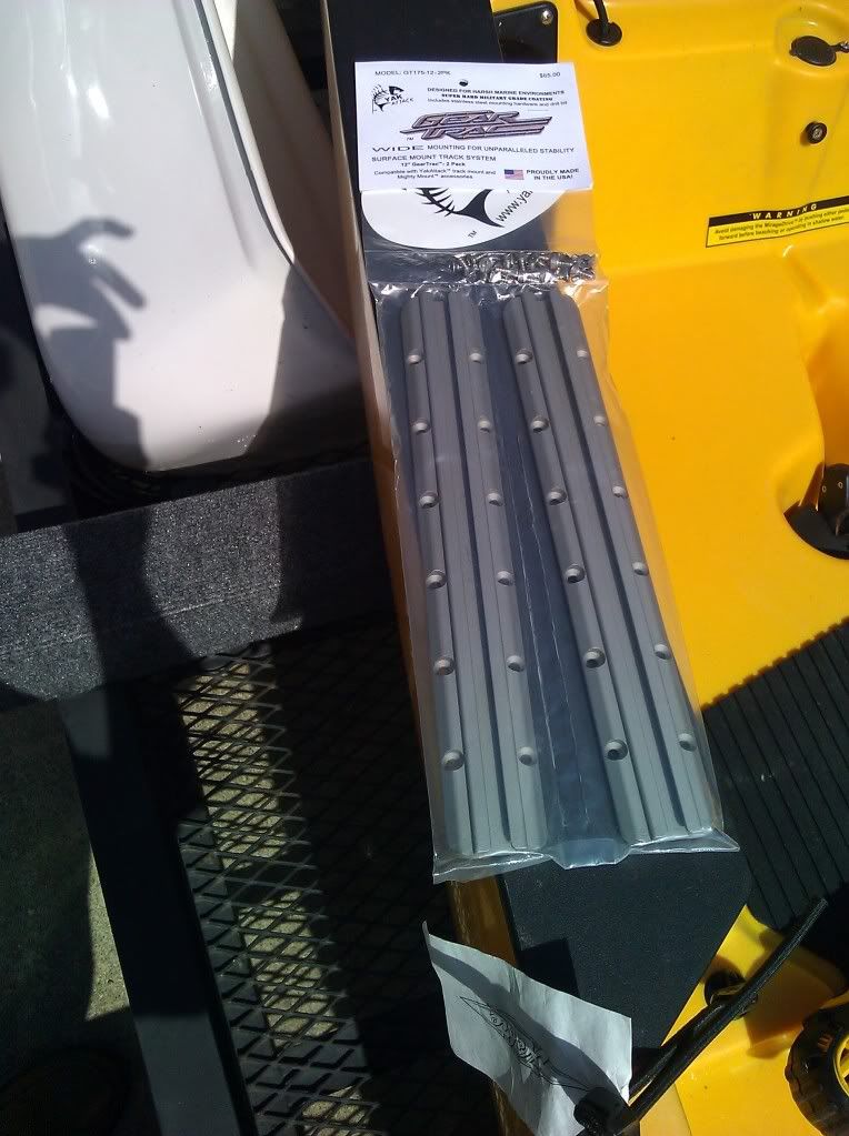

It was time that I started rigging out the Pro Angler and wanted to share it with you guys.
First I needed to get some GearTrac to mount on the PA so I could mount my depth finder, rod holders, camera mounts and transducer. I wanted to mount my equipment this way so I could move it from yak to yak.
GearTrac Installation:
First off let me tell you how easy this is to install. YakAttack will send everything you need with the exception of a drill.
I placed the GearTrac where I wanted them on the side plates. Take the drill bit provided and drilled two holes at first. I forgot to take a picture of me drilling out the second hole so I placed the bit on top of the screw where it needs to be.
After screwing the screws on each side, drill out the rest of the holes where the screws are to be place. This away the holes will all line up. Tighten the screws by hand to make sure you don't strip out the holes.
I put the GearTrac on both side plates in order to move stuff around. Here are a few pictures of the finished product.
