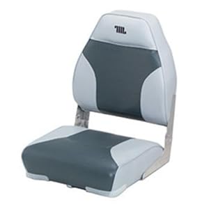

I installed this http://www.amazon.com/gp/product/B0000AXXAQ/ref=oh_details_o06_s00_i00 seat in my pro angler without any modification (to a 2010 pro angler) other than picking up some longer screws. It sits higher, has a smaller profile and is pretty comfortable (for me). I can access the tackle hatch much easier than before. Image
I signed up to get the amazon credit card to save $30 off and it ended up costing me $15. Got the stainless screws at west marine for a couple of bucks. Took all of 3 minutes to install.

Megaweapon: Glad that cushioned boat seat worked out for you. I installed a similar seat from Bass Pro Shop and found that the tilt of the PA seat frame made the seat tilt back too far. The angle of the back is not adjustable on those boat seats. Also found the seat a bit narrow, so I went back to the original Gen 1 seat on my 2010 PA14.
