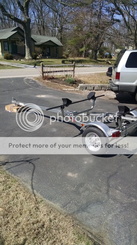

I just purchased a Malone trailer too and have it setup for an outback. Here's a picture of the height Eric I assume is talking about.
Eric I'm giving mine a try tomorrow and I'll see if the height becomes an issue with the outback. If I was to suggest anything I'd say remove the uprights for the cross supports and mount the cross supports on the frame of the trailer. You should be able to mount the cross members temp and give it a shot before doing a permanent idea.
Another idea if I had to add without modifying the trailer is to add some style of wood ramps with glides that come off the rear cross pieces to an angle to ground. These would support the kayak itself and give you the added idea that they carry the weight so you don't as you pull the kayak to the upper supports.
