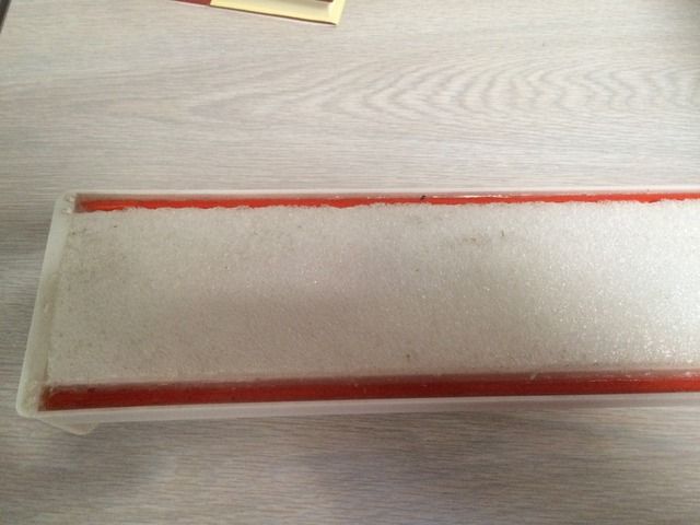

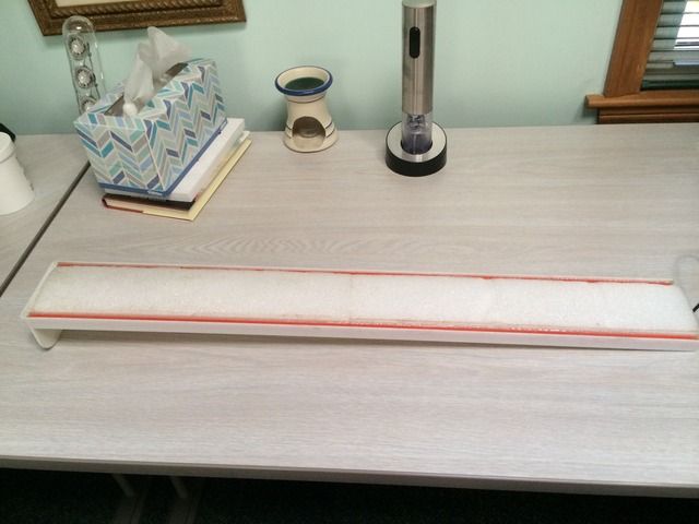

This was not my idea but i found it somewhere. I reinforced my Hawg Trough with two pieces of driveway maker that you would use in the winter. Cut it to size and siliconed it into the slots underneath the trough. I siliconed some closed cell styrofoam to the bottom center section. Now it floats and is unlikely to snap in half. The plastic is thin and brittle on the troughs. Easy DIY project and it works.
