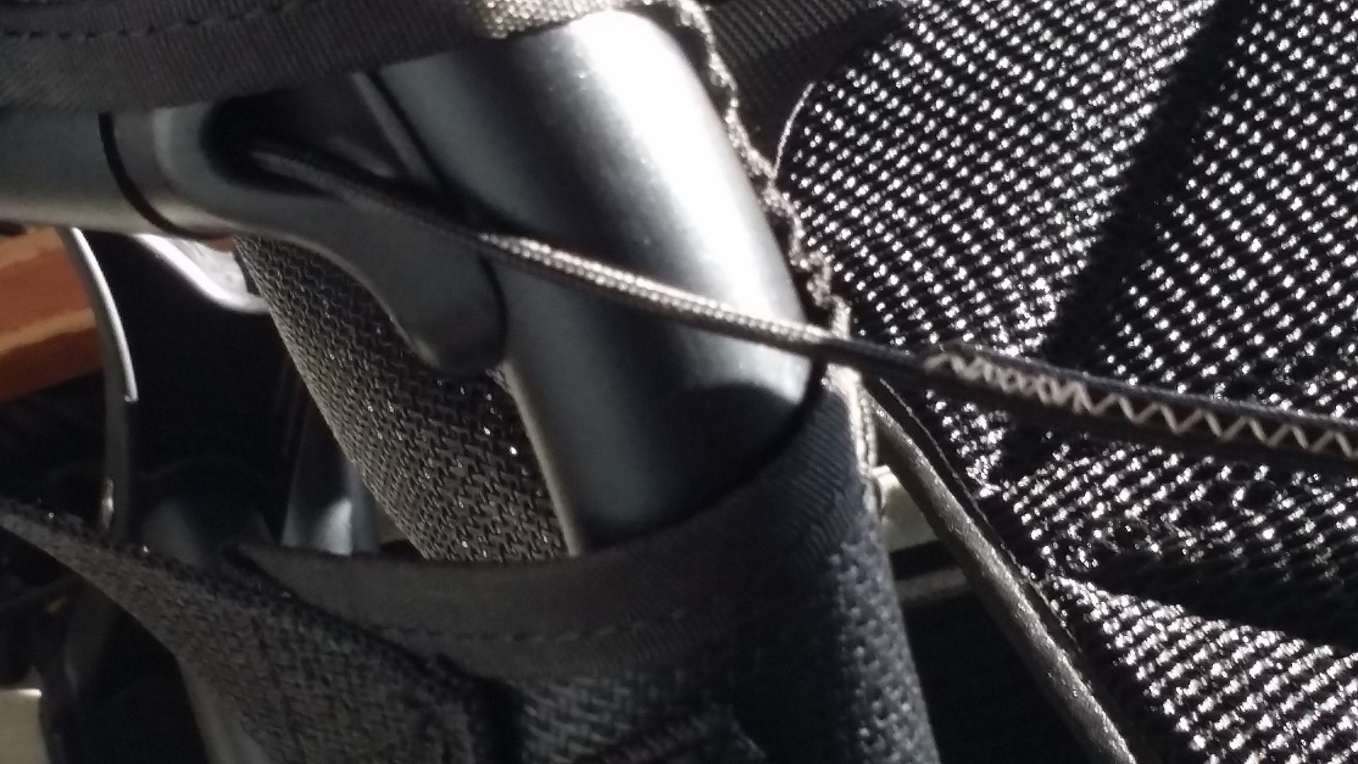

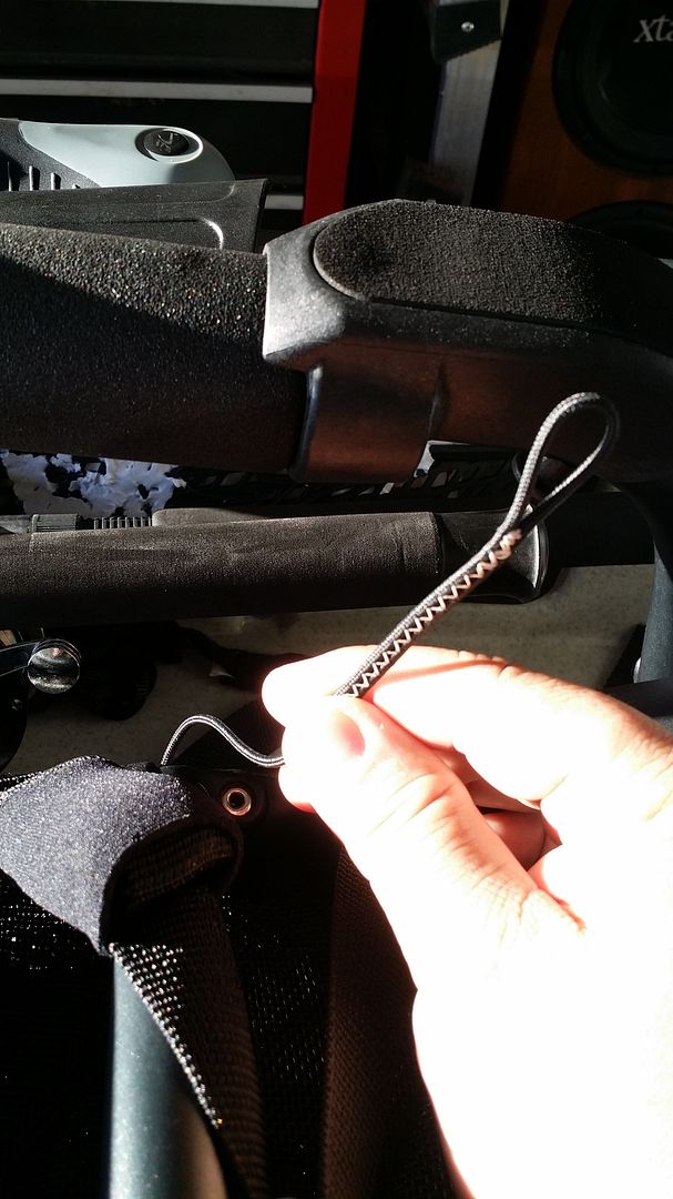

My 2nd trip out pedaling out to sea the seat recline chord braid came apart and wham I was instantly laying flat on my back. Frustrated I continued thru out the day like that luckily it was a calm day not much wind and swells.
The next day I took my seat back to the dealer at Maui Adventure Sports in Kahului Maui, they fashioned a parachord and double stitched the ends 10x stronger than the original. So for us 300 pound plus kayakers I would recommend you do the same. As i examined the seat that day of the seat fail, all that holds that seat in the upright position is that little nylon braided chord that can give way in a moments notice...

Do you have a pic of the work they did?

I tried to upload my photos today. But how the heck are you supposed to do that? Ill try again later...
PostPosted: Tue Oct 13, 2015 2:40 am
Joined: Fri Oct 09, 2015 11:18 pm
Posts: 4
Here is some pics of the upgrade work...
I think this will outlast the factory chord for sure...

We did experience a vendor change to the cord material... This allowed the splice to slip. We had to lengthen the splice a bit... fixed some time last summer or spring I believe.
