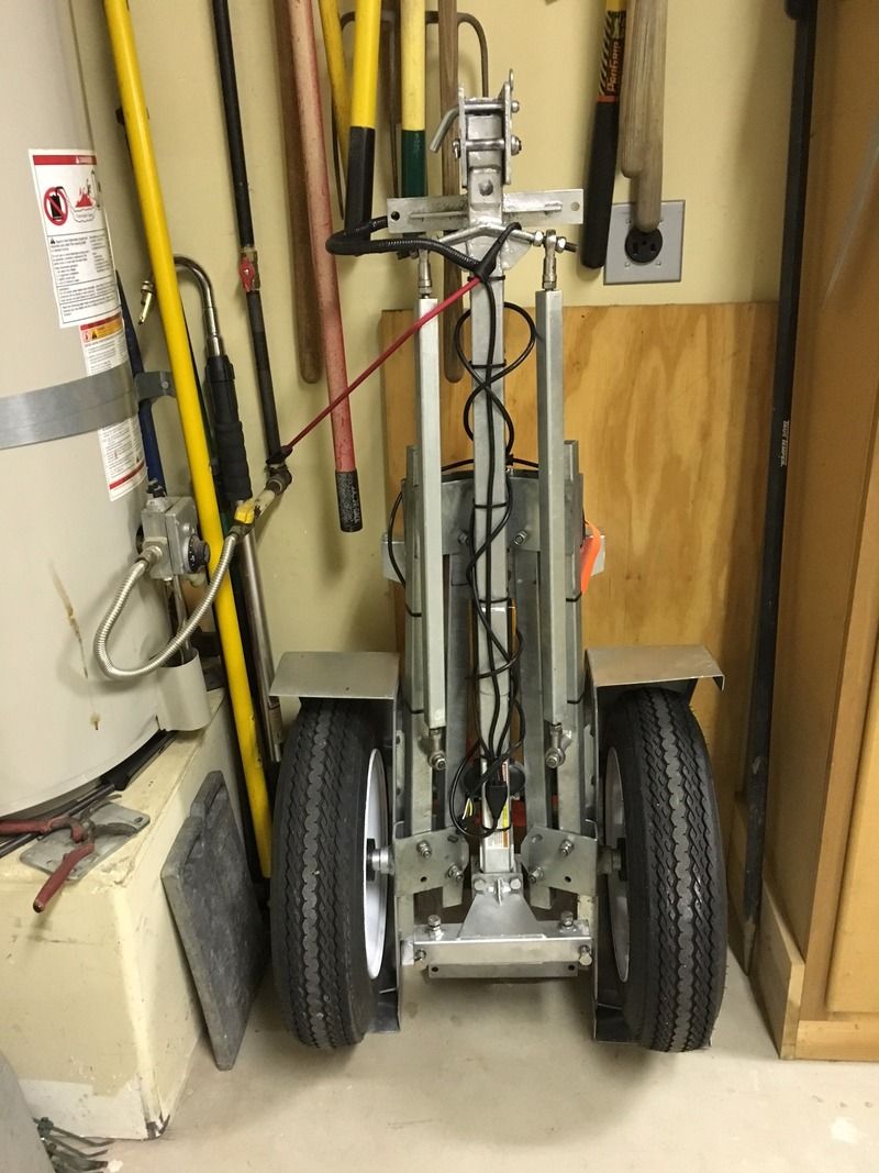

My PA14 trailer solution . . . Bulldog Folding Trailer with 12" wheels. Works great for me and takes up very little room when folded up. Set up is pretty quick installing the front and rear cross bars and strapping on a couple 3" PVC tubes. Have taken two 300+ mile trips so far without issue.
