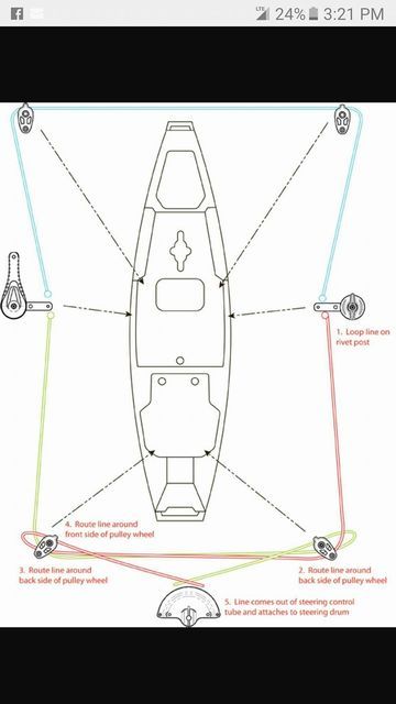

Update to rudder line installation 2012 PA12
Someone shared this on the Pro Angler group on FB. Extremely helpful for the routing (especially around the rear pulleys)
If you're on FB, it's a great group to be part of. Good info shared there.
