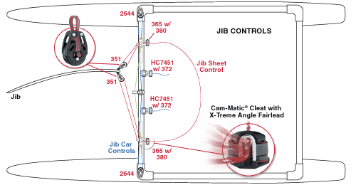

Okay.. it took awhile.. but I hunted down an old thread with some pictures and diagrams..

I just realized you need the older style... dang-it... I know I had a picture of that somewhere... *digs in archives*

wow.. had to hit an old webserver of mine... found them:

That's funny, I was just getting ready to go run the lines. So now I'm really confused. I've got the "old style" but I've got two pulley's out on the sides. Any clue as to why and how I rig it? I'll go snap some pictures if needed.
Thanks for all the help though. I appreciate it.

Barren's old style ones are not rigged correctly. Use the photos in his first post as a guide.

Okay. I can do that. Does that mean that the two pulleys (sorry, I still need to learn the terms) are pretty much useless in my case? Or should I have two more lines that make use of those?

Block is the word you're looking for (=pulley)
The part that rotates in the block is called a "sheave" (pronounced "shiv").
Those blocks (mounted on their sides, I'll bet) were probably part of a jib traveller control system. If you're just getting started, you don't need them right away.
