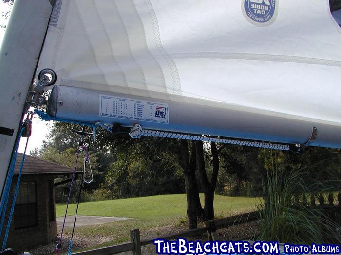

My boom has something just like a mast tang for attaching stays. It is on the bottom of the boom, about 30 inches from the mast and "pointed" towards the mast. Can anyone let me know what it is for? I can post a picture if it would help.
It's an attachement for a vang or a preventer (helps keep the boom out to one side when sailing dead downwind in light air). Most of the racers use a bungie with a hook in it for that. You hook it into the tramp opening in the front crossbar (in the corner).
