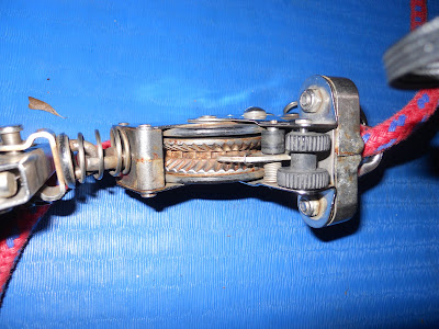

I have a broken spring on the main sheet ratcheting block for my 1983 H18. It is a Seaways block and the small coiled spring that pushes on the ratchet arm is broken. The spring wraps around a pin between the two side plates of the pulley, the pin appears to be press fit.
Is a replacement spring available and how do you replace it. I am guessing you would need to press the pin out, replace the spring and then press the pin back in. I have a press available to me at work.
I guess the other option is to replace the whole pulley with the ratchet and jamb cleat but that sounds expensive. The rest of my existing block is in good shape except for this small spring.
Here are some pictures:

If you took the block to someone in the auto repair business they would have access to a press. They should be able to get the pin out. Then go down to your local hobby store that sells radio controlled airplanes, they have a tool to make wound spring landing gear legs. They also sell the piano wire that you would need to create the spring with. It could be done, would be a lot of leg work and some favors possible called in, I would just buy a new block lol, even if you are without surplus cash right now there must be lots of used blocks laying around.

The process was a lot tougher than I thought, the pin that hols the spring and ratchet arm was actually shouldered and held between the plates with the rivet on the knob to turn the ratchet on and off. It cannot be pressed out like I originally thought and tried on the old block :( . After about 2 hrs work I got the old spring out and put the block back together and everything seems to be working good. :D
