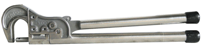

Whats the best way to put the new batten protector/pocket thing? I tried using a rivet tool but then all the rivets pulled through after the first sail.
PostPosted: Sun Feb 21, 2010 11:13 pm
Posts: 1457
Location: Santa Cruz
You set them with a tool like this, but like I said, I've broken a lot of protectors with it. The plastic is brittle.
Hobie probably uses something like this:
That's what my sail maker uses.
