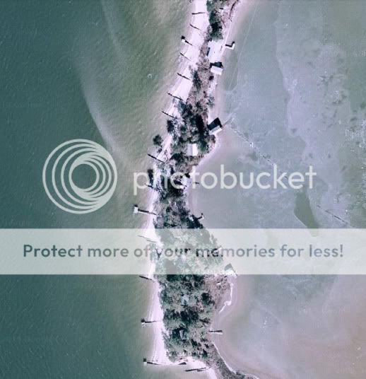

JJ, by nature I am probably a high tech controls guy, however the cabin environment heavily favors the low-maintenance items. The salt air and constant weather is tough on things, we are somewhat "exposed". Mine is the place which has the "boat wake artifact" leaving the boathouse on the creek side, I guess this satellite picture was taken right after I left for fishing.
My plan is to keep the boat on the beach when I am down there, and pull it up on the "high ground" when I am not.
