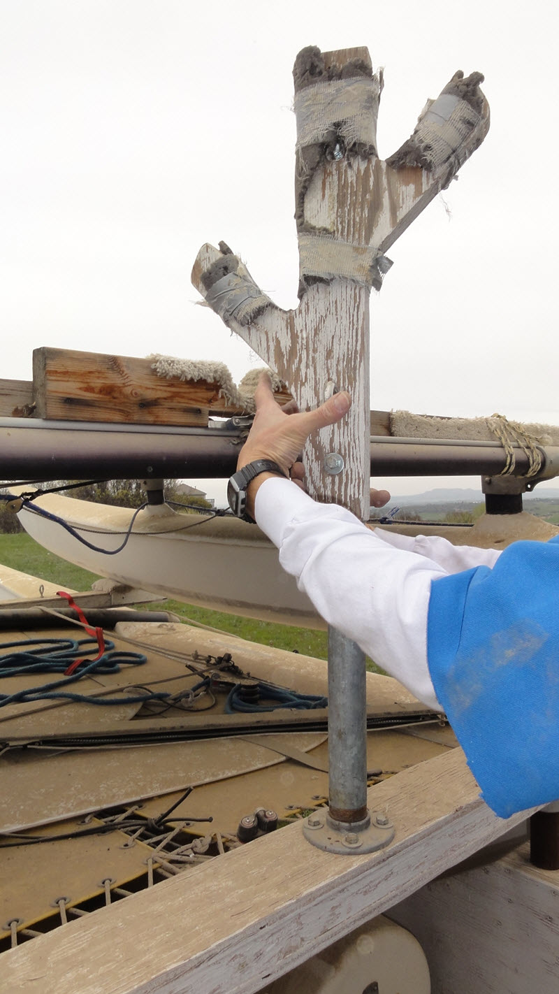

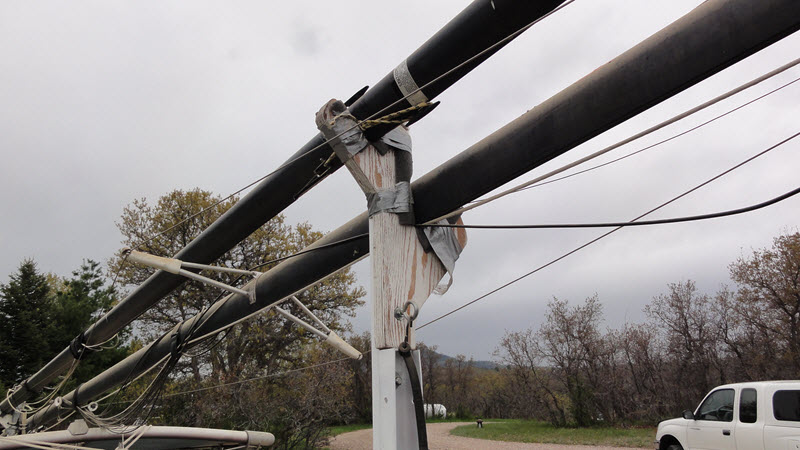

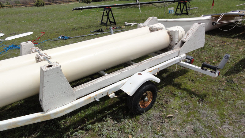

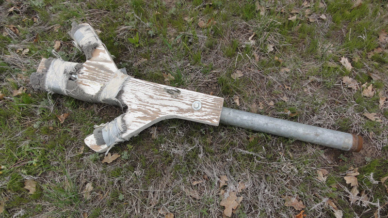

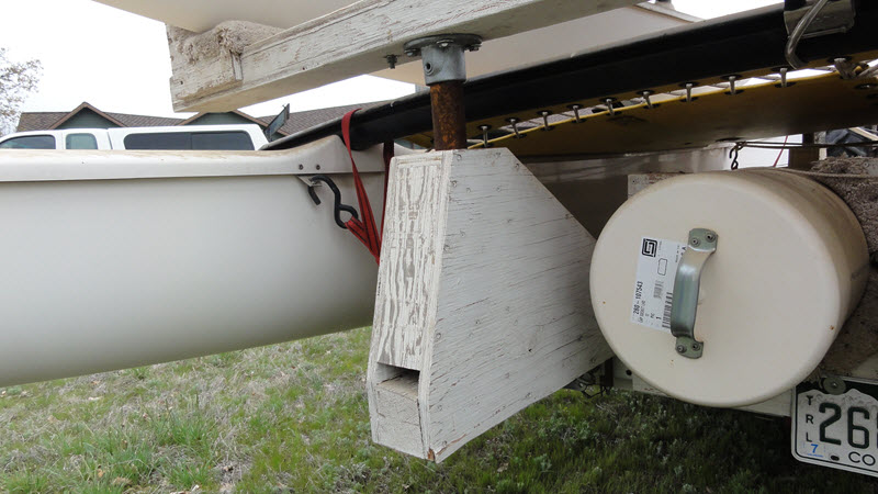

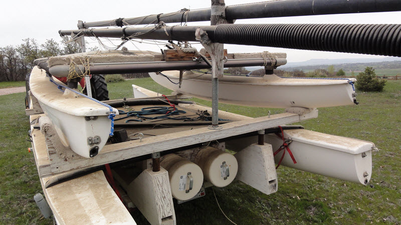

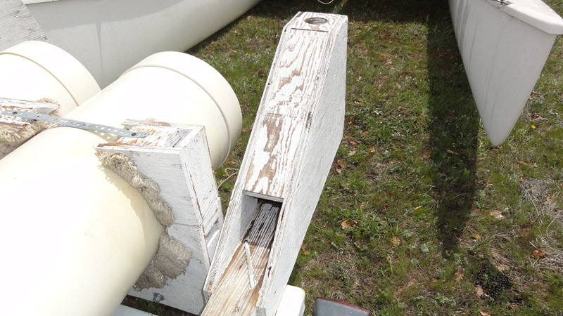

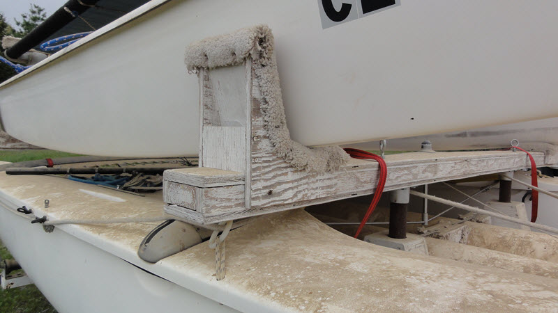

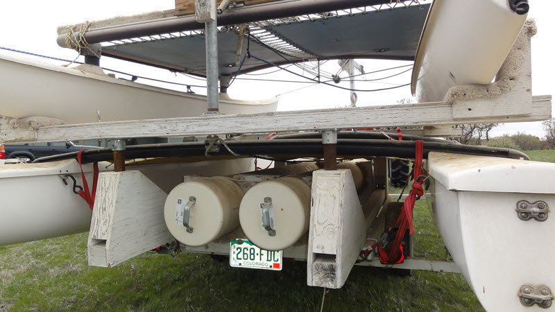

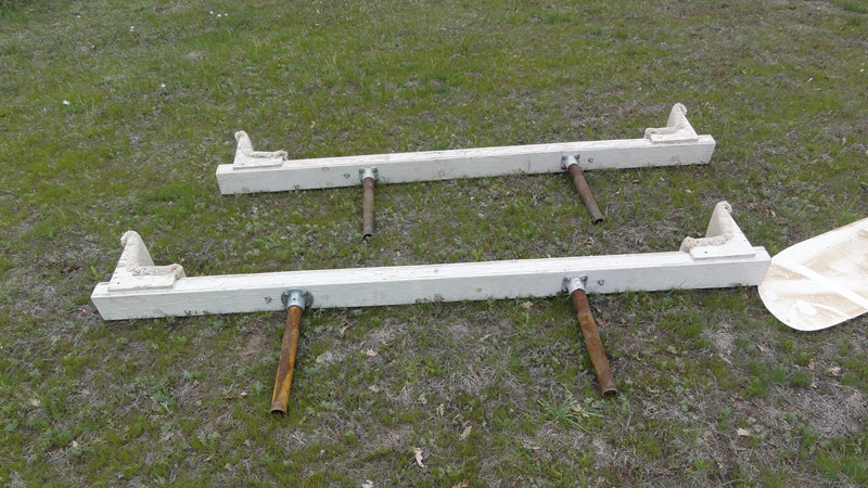

My dad and I did this to set a H14 on top of an H18. It's made from 2x4s, plywood, some pipe, and pipe fittings. I'll get some pictures soon but there is a structure at the front and rear of the H18 tramp with sockets that point up, but are short enough that the dolphin striker will clear. Once the H18 is on the trailer, two upper structures slide down into the sockets and provide support for the hulls of the H14. These upper structures are like a beam with two pipes sticking down, one at the front and one at the back. The H14 is lifted by 2-4 people up onto the upper structure and tied down. The back structure has a threaded pipe flange bolted to it, and a rear mast support is threaded into it once the H14 is in position. The rear mast support is forked to hold each mast, and the front mast support has a matching fork pattern. There are 2 sail tubes under the H18. Tie everything off and off you go! The trick is needing 2-4 people to lift and lower the H14 from the top position.

PostPosted: Mon May 16, 2016 8:09 am
Joined: Tue Jul 21, 2009 10:58 am
Posts: 6
Location: Denver, CO USA

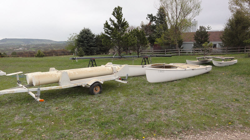

Cleaned the boats up and got them ready for the water this weekend. Excuse how dirty they were, but here you can see pics of how our double stack works:

PostPosted: Mon May 16, 2016 8:43 am
Joined: Mon Jun 25, 2012 9:56 am
Posts: 128
Location: Grand Haven, MI
Thats some serious custom, but it looks like you have a much stronger trailer to being with.
