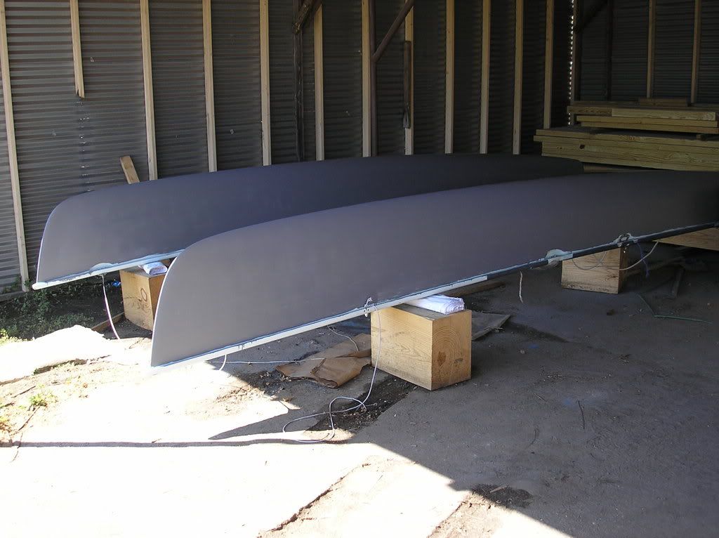

stripped and sanded off all the god awful anti fouling and sanded

primed
