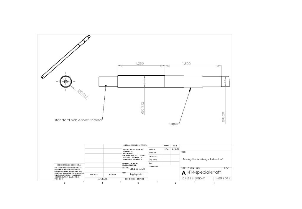

I would interject here that Hobie has marketed the drive in a way that would promote high-energy pedaling. I suspect we've all seen the videos of a Hobie pulling against one or two world-class paddlers. Obviously, that's just a promo to show how much power those two cute little fins can generate, but it is suggestive of support for competitive and powerful pedaling. At least it is for me.
Based upon what I am reading here, it would seem that the more powerfully one pedals, the more deflection the shafts would experience. The science is interesting and suggests that an experiment or some math could tell us where the sweet spot lies. The key question being how much pressure can be applied to the shafts without exceeding their yield strength, and what that translates to in terms of cadence and forward velocity. I would guess that pushing through water is more exponential than linear in terms of force increase for an increase in velocity. You probably don't have to drop speed much to reduce the force into the safe range, but I don't know nor do I know the formulas that would allow me to model it.
In terms of looking at stronger metals, don't forget that the whole drive is based upon the shafts that are currently provided. If you switch to a shaft that would snap before bending, albeit at a higher force application, then the shaft might remain straight while some other part of the drive was being snapped off. Make a super strong shaft and you'll have the opportunity to find out what the next weakest part of the system is. Personally, replacing a shaft once in a while seems like a less expensive alternative.
-bob

bsee: I agree with you 100 percent, adding the shaft design below may force the unit to fail at the next weakest link in the chain (under racing conditions), so it's likely many more parts would need to be re-engineered and custom built for extreme racing.
Rnykster :
Here is a design for a racing version of the Hobie Mirage shaft made from 414 or 420 stainless steel hardened and PVD coated. This shaft design does not exceed the yield thrength of the metal. The larger 5/16 diameter near the top should fit into your existing fin ( I tried it and it works, you might need some teflon grease to get it in though). I advise adding a small radius at the base of the thread before heat treat to help lessen the extreme stress at the base of the thread, and make sure the flange is bottomed out on the brass fitting. Take to any metal shop to have built (they will also verify the design and stresses for you (any PE can do this)). Also make sure it's polished with no imperfections on the surface. Now win some races with it.
Bob

Bob, nice analysis on the metallurgy! Your innovative and technical talents are amazing -- it's sure great to have you as a forum member!
I have a Drive set aside for use in racing. Some of the Hobie parts are modified -- masts are pre-bent for a larger sweep and last about 200 miles reliably. Any new parts are fully tested at least once before a race to flush out any possible defect and make sure they are well seated. So far there haven't been any surprise failures. In any event, I take full responsibility for the longevity of these parts.
In Rnykster's case, I think stock Hobie parts are plenty strong for him for a certain period of time before he wears them out or induces them to fail. For example, he knows that he gets 800 miles+ reliably from his masts, so if he put new stock masts on for $35 per pair, he should be in great shape for any race. Same thing with cables. In fact, since he already has a spare Drive, why not stock it with fresh parts and keep it for racing?
