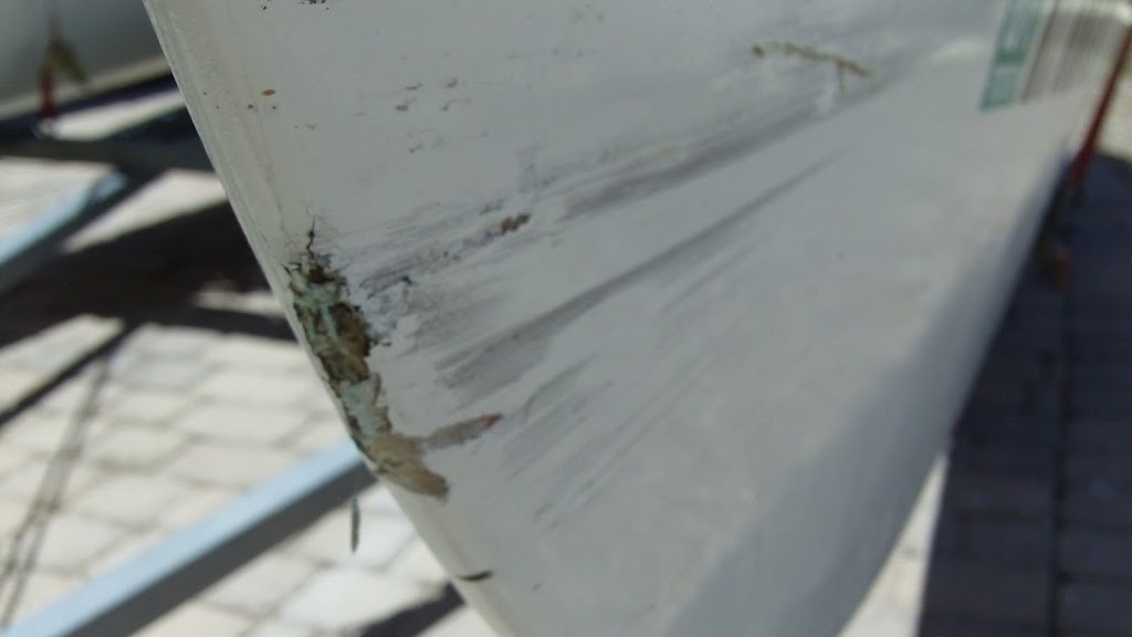

I'm looking for the best way to make the necessary repairs to my hull. Please see the pictures as I don't know the best way to describe the damage. The main damage I would describe as a tear. Approx. 5-6inches in length I don't know how deep or how bad it is other than the area immediately surrounding the actual split now has some flex whereas I was looking pretty solid before hand. Additionally there is damage to the bow area and I can see some fabric layers where some chunks are missing. I believe this to be mostly superficial as I know this part of the hull is as strong as it gets with the two pieces meeting there.
So what's the best way to make good, better than new, repairs? I've seen a lot of information out there and some youtube videos, so hopefully I don't need step by step but instead what is the best methodology and products to use. Also, a former owner repainted just this hull somewhere along the way. The finish is very flat and there is much debris caught under the paint so if this would be a good time to recoat the entire hull I would like to know.

The bow is an easy repair, and really so is the side - it's just scarier to do because it's going to get a lot worse looking before it gets better.

As to the repairs, I reviewed all the "This Old Hobie" articles. If my understanding is correct the side damage will be "gets worse before it gets better" type as I will end up completely cutting out the entire weakened area and putting a 3"x9" opening in the side of the hull. I may need a few beers before taking a roto-zip to the hull. Then, using the products in the article, rebuilt the area. Any suggestions for doing the foam/fiberglass laminate on the interior of the hull? I do have a 5" port on the top of the hull but it is more than an arm's length away from the damage.
As to the bow damage, I don't want to cut anything away but instead sand down to clean, unaffected hull and essentially follow the steps for a "bottom-job"? Speaking of bottom-job (bj in the interest of time), how do I know when one is necessary (and yes, I know, never too many bj's)? The paint is already gone but as I stated before, a previous owner painted the hull but i seriously doubt it was a proper gelcoat. Since I'll be doing these repairs i want to sand clean the entire hull and gelcoat the whole thing so it looks like new.

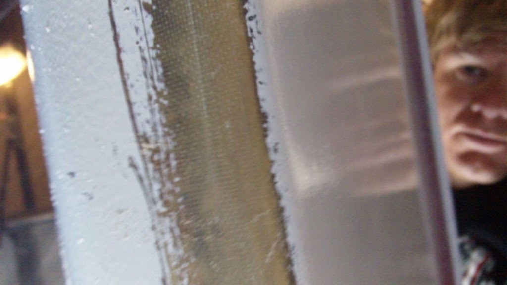

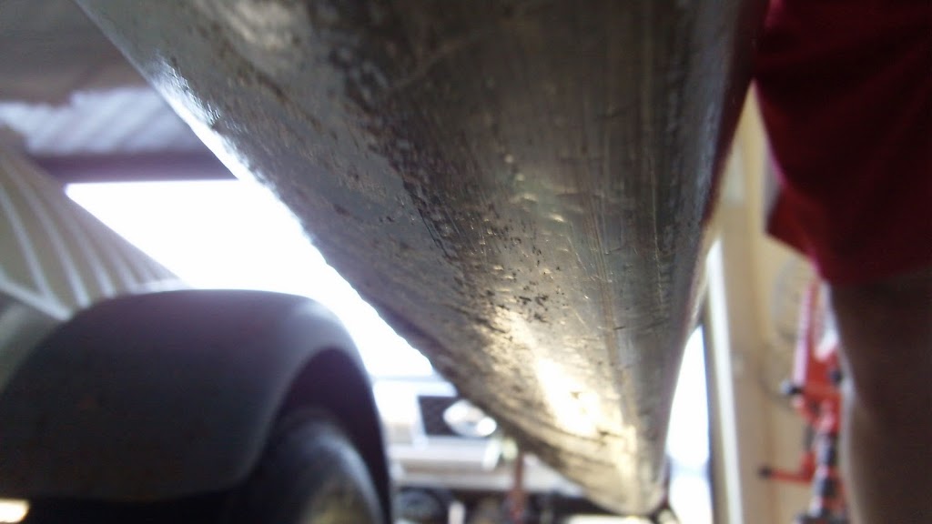

I'm including two pictures at the bottom of the current keel area. Is there a template I can download to see what it looked like when new? I don't really think I need to add layers but I'm basing that simply on the fact it feels solid.

The bow's easy. Grind out broken glass, re-glass, fair, gelcoat and you're done. Don't rotozip through the side. Gently remove the outer skin and broken foam, and assess the inner skin. Chances are you can laminate a new piece of glass ON TOP of the inner skin. The "old boat" article with the fishing line is awesome, but that's not the easiest way for a beginner to do that repair.
When you get to the inner skin, rough it up with 80 grit paper and cut out a piece of glass (7oz is what I use) that overlaps the damage by about 2 to 3".
Tape a piece of wax paper that's larger than the glass to a piece of plywood.
Wet out the glass and allow it to set up leather hard (Don't let it cure fully).
Mix a small batch of vinylester resin and glue it to the inner skin of your boat.
Re-foam with divinicel or similar 1/4" foam. Glue in place with thickened resin.
Fair and glass the outer skin leaving room for a layer of gelcoat.

What I'm saying is, you'll have better luck (stronger repair, better bond) if you glue the patch from the outside of the inner skin. Use a DA with 80 grit. Don't take more material away than necessary.
