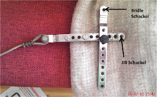

Hello!
I need advise about rigging my Hobie 16. It is from -86 and my question is about the forestay rigging.
This double chainplate is situated at the bottom of the forestay (picture is on our blog)
I wonder if anyone has a picture or an assembly-manual that shows the correct way of connecting it. Last summer, wich was the second I found one way of rigging it that workes, but i want to be sure that i am using the equipment the best way.
And please what is the english term (i am swedish) for this rigging-solution, since it is not in the manuals for the original Hobie 16.
Thankful for assistance, will go rigging this weekend.
Jesper

It's pretty easy, the two bridles coming off the bows go to a shackle. The bottom hole of the chainplate gets the pin from the bridles shackle. Then the forestay goes into the top hole of the chainplate. That's it! The jib hooks into whatever hole in the chainplate you would like, depending on how much mast rake you run and how your boat is setup. The second chainplate is usually redundant, for boats that run tons of mast rake and can't attach the forestay without the second chainplate. They usually run a small bungee too to keep tension on the forestay after the rig is tensioned, so it doesn't flop around the jib and chaff it.
Good luck!
Blair T

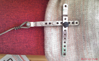

Then I have had it a bit wrong. The guy I bought the Hobie from had the two adjusters like a tool to get more tension in the forestay when the jib is up. Look at this picture
The bridle schackel was attached to one of the adjusters, the jib to the bottom of the other. When the jib was raised and put under tension, the forestay then got more tense.
Was that a bad idea or was it acceptable?
jesper

The "forestay" on a 16 only holds up the mast when rigging. Once the jib is up, the jib wire takes the full load. You don't want the "forestay" to have any load at all. That would take tension off the wire in the jib luff and allow it to bow to leeward which is bad for upwind performance. The jib luff wire should be tight and the "forestay" loose to the point of drooping several inches. Sometimes guys add a bungee to tension the forestay to keep it from flopping around.
The second adjuster is typically for extending the forestay to get more rake aft... without tension on the forestay.
For many years the forestay has been too short to rig at max rake. That was corrected when we went to the Aussie sysetm several years ago.
