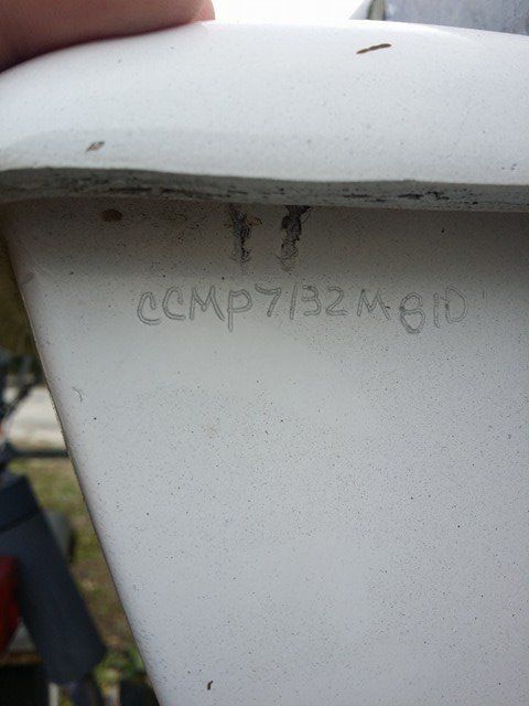

I looked at a Hobie today, the gentleman is selling it on consignment and while I was looking at it changed his price from $1800 down to $1300. It is a '81 if I read the serial number right, in white with a trailer. The trailer seems in fine condition (minor rusting on the surface) and includes a good long sail box.

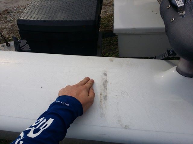

The boat itself looks like it was painted white at one point instead of redoing the gelcoat an the paint is flaking in small areas. But I'm worried about the hulls, in the pictures below my hand shows where a soft spot starts in front of the forward pylon, this spot is the same on both hulls. Beyond that the starboard side does have some further soft spots up front of that though I wasn't able to push hard enough to hear any crunching so I think the fiberglass itself is probably fine? It is soft between the pylons on the side as well. And, oddly, the previous owner has affixed a length of woof the entire length of the keel on both sides. I assume it's to hold up when beaching, but I'd like y'alls advice on this.

Here's the serial on the hull, I glanced quick and it looked like the numbers on each matched.

Here's my hand showing the start of a soft spot in front of the pylon.

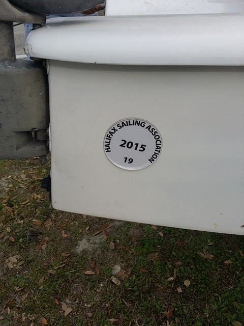

Judging by stickers on the boat and trailer this cat has been sailed for a few seasons up in the NC area.

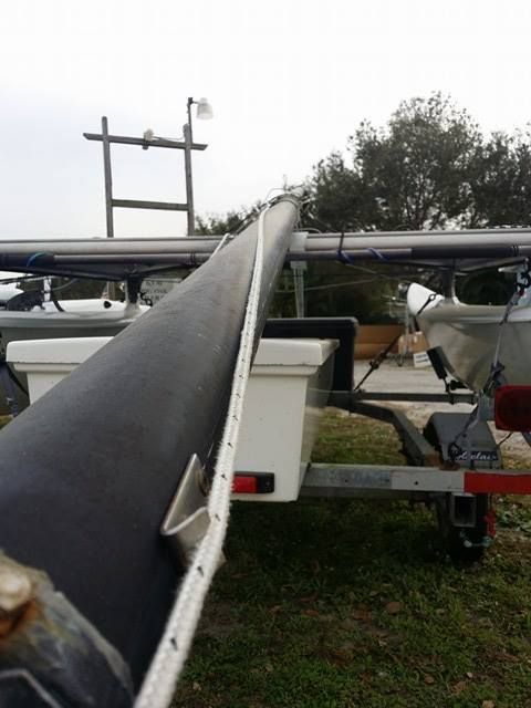

Mast seems to be straight, and most the lines seem alright though I realize I'll want to get new rigging and probably a new tramp cloth, I would hope to be able to do that after this season.

In my humble opinion $1300 is way to much for a boat with soft spots. Maybe location and date is a factor, but I bought my '83 on an aluminum trailer for $1100 in 2008. No soft spots or other damage. I had to change some of the running lines but that was it. I have done some improvements, but the basic boat was sound. If the hulls are painted too, I would pass this one up and keep looking. There has got to be something better out there. Especially in an area like Florida. Just my 2 cents.
Soft spots on the decks in front of the forward pylons are very common on older boats and an indication that the hulls are at the end of their life. Plus you said there are other spots farther up the bow and between the pylons. Do you want to spend your time repairing a growing delamination problem, or do you want to sail?
I would keep shopping around.

No way that's a $1300 boat unless it's the only one on a desert island or something! Sounds like waaay more delam than would be worth fixing even if you were to get her for next to nothing. In that price range, you should be able to come up with a sailable boat needing only minor rigging or line replacement. You might also watch e-bay. If you don't mind driving a ways, that widens the pool of available boats.
