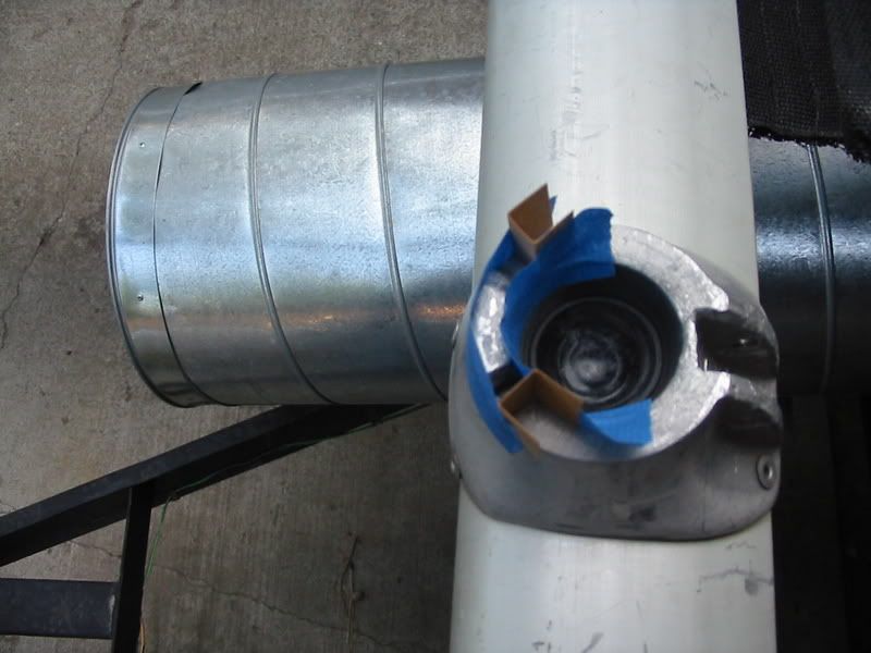

Here's the first step in the "re-build mast step project". I've constructed formwork as seen in the pic below. You can see the cavities to be filled where the original aluminum has been taken away. I'm using "JB weld" as the build medium. It's supposed to have metal-like qualities after curing. Once the cure period is finished. I'll grind and file the stops to suit.
The stop-to-mast rotation point-to-stop angle looks to be about 45 degrees. Can anyone measure their's and respond with the original angle? Otherwise I'll make the best guess and finish file to a symmetrical angle.

skipper0802 wrote:
Good Morning All,
...using "JB weld" as the build medium. It's supposed to have metal-like qualities after curing....
Nice set-up job.
My worry would be the bond to the mast step. It will get pounded and could fracture apart. The bond you will be getting will be a mechanical one, whereas a weld will "bite-in" to the mast step material.
Another consideration is the maleability of the material you are using. If it is hard, it may also be brittle.
Let us know how it works.
Sail Fast, Take Chances.

Hello Russiet,
Yes, material viability is a question. I have nothing to lose by doing this first. The JB material is thick and I'm waiting for a full cure before I take the next picture and before the filing/grinding step. I'll post as I progress.
And....If it doesn't work or last, then I'll just purchase a new mast step. Either way I'll be ready for the next sail!

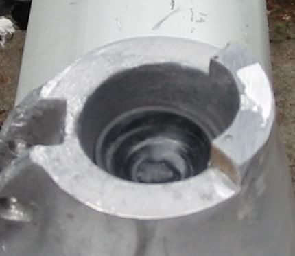

Here's the next step in the project. After the medium has cured, I removed the "formwork" leaving the added material in place:

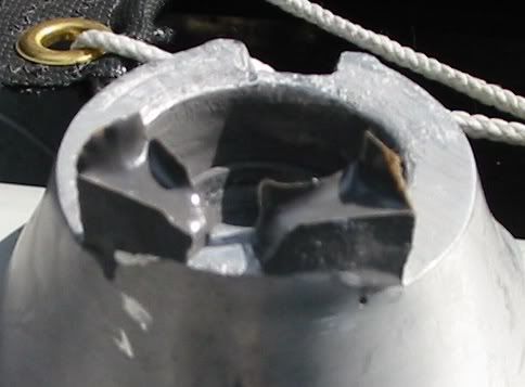

About 8 minutes of bulk grinding with a rotary tool and finish filing gave me this:

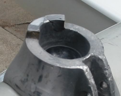

and
I'll report how this fix does after the next sortie.
Eric

Well, it certainly looks damn good.
I hope it holds up like magic. But like you say, there's not much downside to it.
