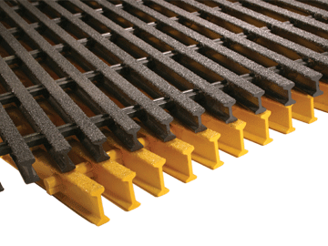

I'm considering going with some Safe-T-Span grating. Looks like I can get a 2 ft x 6 ft piece from Grainger for around $250. Not too bad compared to tramps, or even compared to lumber and stainless hardware when you factor in build time.
Cut it in half lengthwise then bungee it to the amas. Highly resistant to sun and salt.
http://www.grainger.com/Grainger/SAFETSPAN-Grating-4AUC3?Pid=search
http://www.fibergrate.com/frp-products/pultruded-grating/safe-t-span-pultruded-gratings.aspx
Best part is, it comes in yellow! Second best part, I might be able to use them as a type of sand ladder for getting unstuck on the beach.
If I decide to use it, I'll be sure to let you know how it turns out.

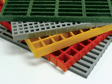

I was just looking at the all the FRP profiles and was checking these out. Those are the I-beam grates, and they make lighter versions too.
At half their price I would do it for sure. Right now, I'm in sticker shock... :cry:
