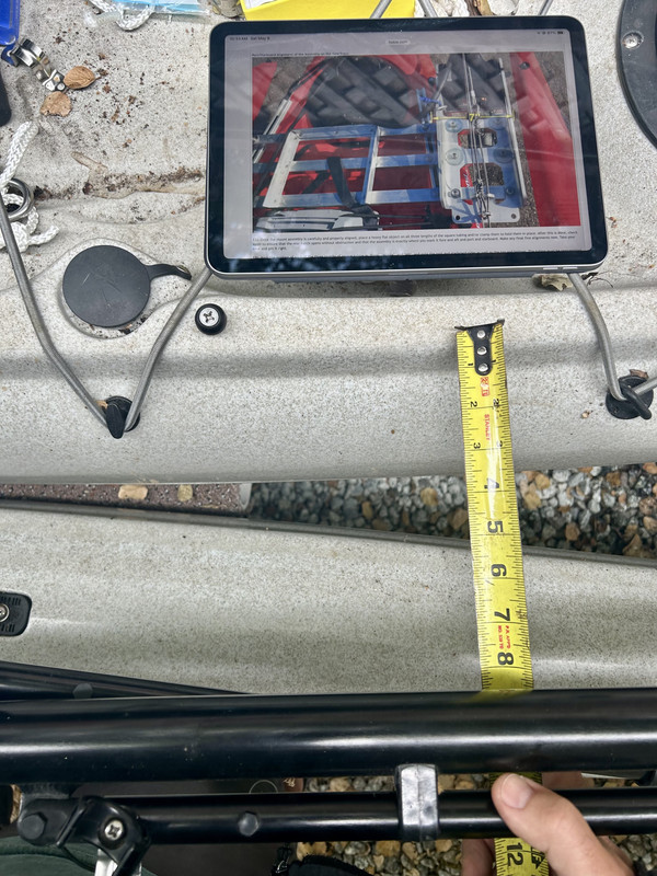

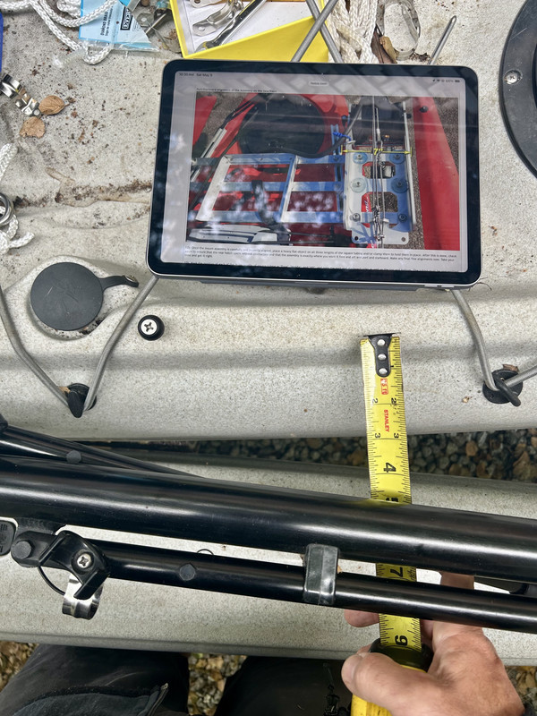

I have come across an interesting issue when using your A-Series Motor Mount on a Hobie Mirage Adventure Island (AI). This is the single person version and NOT the Hobie Tandem Island.
On the Adventure Island (AI) the aft most deck-mounted crossbar is actually behind the cockpit seat. As a result and crucially when the Adventure Island (AI) is in the folded position for trailering the Aka folds right in the way of the motor mount. This is different than the Tandem Island which has the crossbar in front of the rear cockpit seat and the folded Aka is fore of the motor mount.
From your instructions the port end of the A-Series bracket needs to be approximately 7 inches from the port side of the GearTrac where the square tubing contacts it aftmost. From my measurements on the Adventure Island (AI) that distance with the folded Aka is only 4.5 inches.
The solution I am thinking to do when trailering is to just depress the spring-loaded buttons on the deck-mounted crossbar and slide the aka out. This allows the Aka to be moved further to port and out of way of the motor mount. Detaching the Aka would provide at least 8.5 inches or more clearance.
There have been some posts about the Aka popping out of the deck-mounted crossbar on its own. With the frequent detaching of the Aka it would be well advised to install backup "keep-out" lines that tie the Aka to the deck-mounted crossbar to prevent separation.
On a side note I am looking at the latest Torqeedo Travel Ultralight motor. Since it still uses the A-Series Motor Mount I am thinking your motor mount would work fine?
And the latest Travel Battery Ultralight could still sit in the Optional Battery Tray you mention in your instructions.
Thank you.
