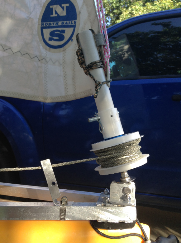

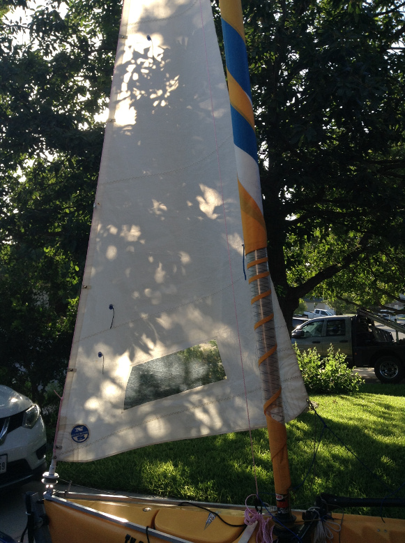

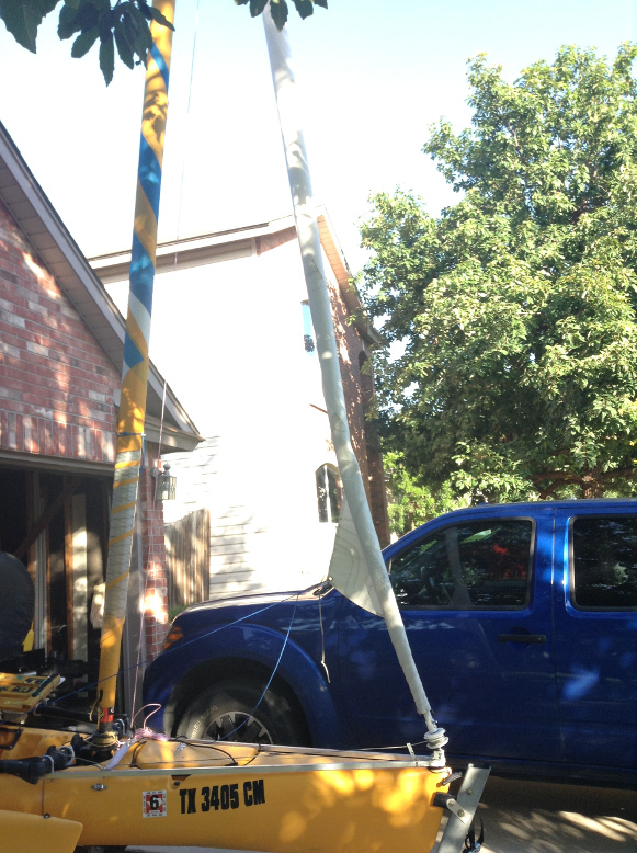

My jib setup is ready for another test on the water. I basically did what you recommended, tpdavis. I cut off the PVC mast and the sail furls ALMOST as good as it did with the mast.
Here is my furler and how I attached the tack of the sail.
And here is the open sail.

Nicely done! That bow reinforcement looks great too. That should solve any front hatch issues! Bet you could add a bowsprit easily now if you wanted.

Thanks Greg! The only thing that I don't like about the brace, is that it makes it hard to hook the hatch bungees when securing the hatch. I might have to come up with something for that. Yeah, a bowsprit should be pretty easy to add. If I ever decide to add a spinnaker, the boat will be ready for it!

Have you tried the muggyweld? That seems like some cool stuff! I keep thinking how I wish my bow brace was all welded together.
I used 1-3/4" u-bolts to attach to the aka brace. For the front, I unscrewed and removed the bow pad eye, then used those screw holes to bolt down an aluminum plate that the square aluminum tube bolts to. It isn't quickly removable but it didn't require any modifications to the boat.

So I got to test out the jib today on the water. My first issue was that I had a hard time un-furling the sail. I had to shake and pull, to get it to come out. It worked fine during my driveway tests, so I'm not really sure what's going on there. The sail shape was MUCH better than it was with the PVC mast. Unfortunately, I didn't get to test it for too long. One of the joints on my furler popped loose because I didn't glue it well enough. Also both of my cheap cleats that I was using for the jib sheets ended up breaking. So after a few repairs and mounting some real cleats, I'll give it another try.
After adding a jib, I've also noticed that it's a pain to keep all of the new lines organized. A lot of this is probably due to the cleats I'm using, they're the inline style and aren't bolted to the boat. What are you guys doing to keep everything organized?
