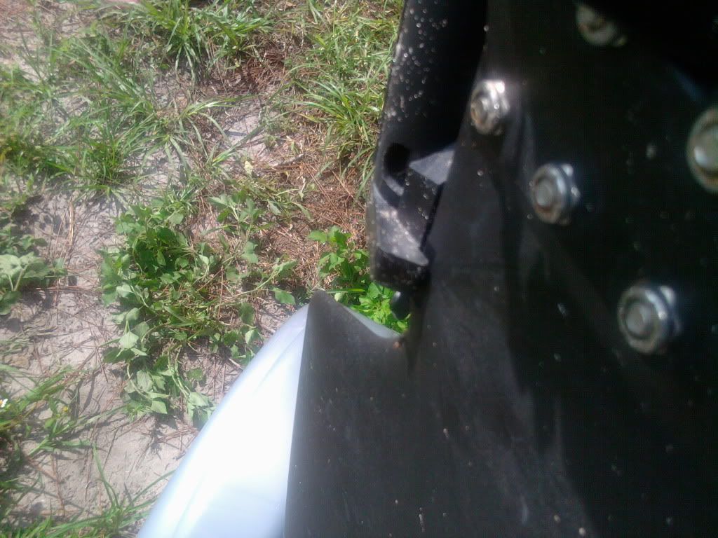

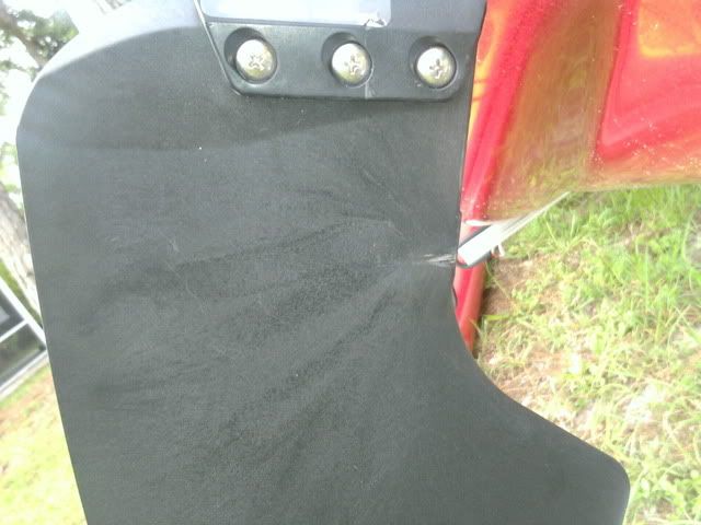

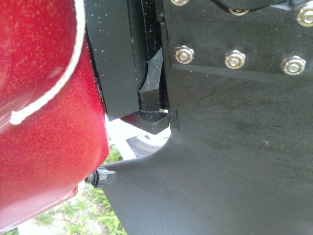

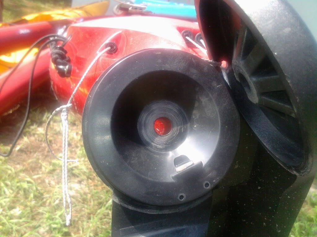

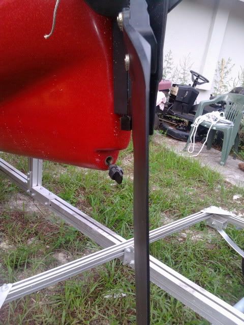

I think I may have figured out what is going on.
I decided to go back and read all the thread content on this issue and then go through the entire steering system to see if I overlooked anything.
I did so and discovered something very interesting.
It seems as though I have a rudder mount that is designed much like that of an AI and not a TI.
In fact the locking tongue and groove on my TI are IDENTICAL to my AI.
Accordingly the rudder never really locks in the deployed position in fact the groove remains 3 to 4 millimeter out and away from the tongue in all positions regardless of how you tension the line.
The spool, washer, line and bolt all seem to be adjusted correctly and in good condition and operating order but the rudder never engages the locking tongue.
The rudder seems to be installed correctly but according to what I am seeing the actual geometry is nothing like what is pictured in the green circle as posted by “Roadrunner“
But rather identical to the red circle in that pic and my AI is identical as well. See this image http://j.imagehost.org/view/0032/z4 found in a post above,
But I will admit that Roadrunner’s post is very confusing, he points to the green circle as being the new design but it looks like the green circle is actually an AI rudder mount. At least my TI rudder mount looks like the RED circle.

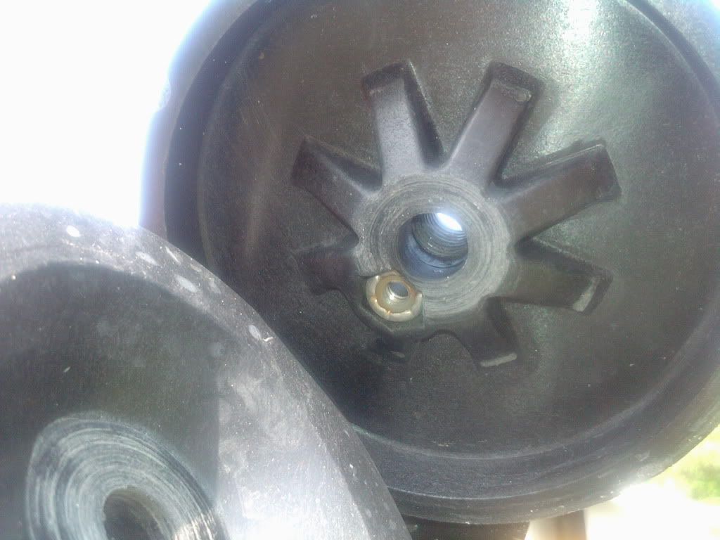

The top half of the spool
Bottom half of spool

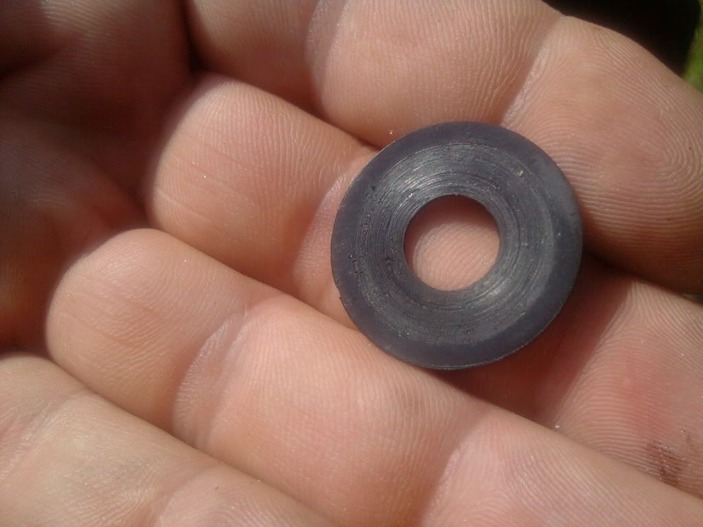

The thrust washer/spacer

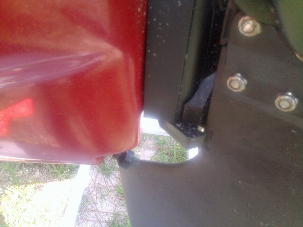

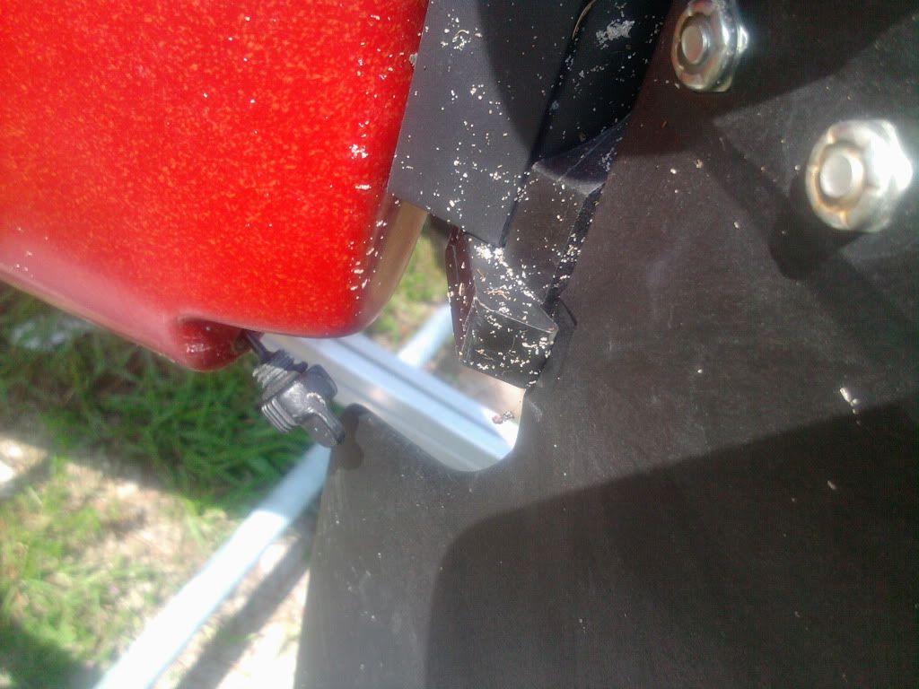

Plain to see the tongue here is the blunt design and is nearly 5 mm out of the groove in the locked position.
Here I am pushing the rudder over yet even then the tongue and groove remain 3mm away from each other.
Here I attempted to re-seat and re-tension the rudder with even worse results.
I have a feeling this rudder mount was a “first design” and has since been upgraded to that pictured in “Roadrunner’s“ post (http://j.imagehost.org/view/0032/z4)
In any case the mechanism simply does not perform and makes sailing dangerous. Until it is remedied under warranty I am high and dry during prime sailing weather….
Oh well… At least I am trying to do something about it and to be heard and not just sitting on my hands.

I also checked some rudders for rudder warpage (which mine is not) and I must say that ALL of the older used Hobies I inspected had considerable warpage, many to an alarming degree, YET they all still functioned flawlessly in a locked and deployed position.
MY un-warped rudder, and if you look closely you can see the 7-8mm gap at the tongue and groove.....
Here the rudder never fully engages the T&S tongue and groove, regardless of how many times it is re-deployed
Note the witness marks located at the middle mounting screw on the bracket and on the rudder about 3 inches below the bracket on the right edge.
I have a new T&S coming from Hobie and I can assure you that it will be carefully assembled and inspected before even being mounted.
Hobie manufacturing needs to wake up and take note here, they have a problem that can be easily remedied with a little careful thought and re-tolerancing.
