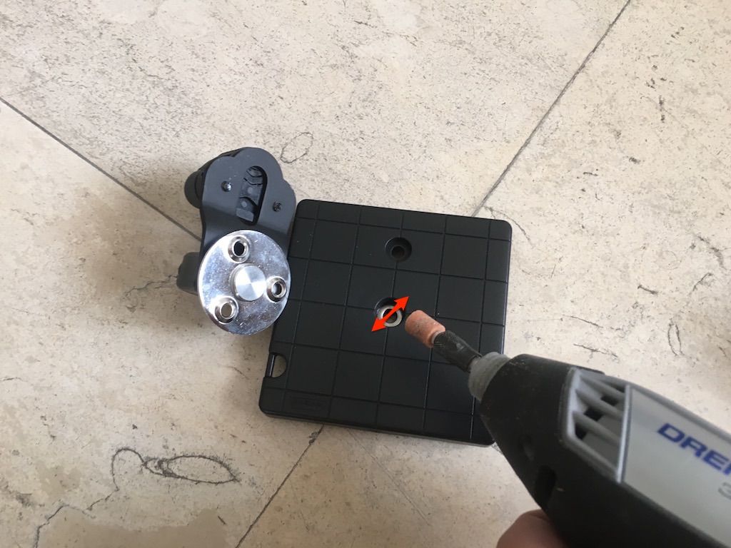

I made a few changes in installation, because I did not want to make holes in the akas. In this way they can be easily disassembled.
first I made this hole wider.
Then I use screws from YakAttack GearTrac - GT175
Then I cut out unnecessary plastic.
Done!

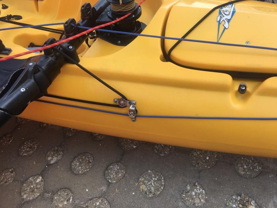

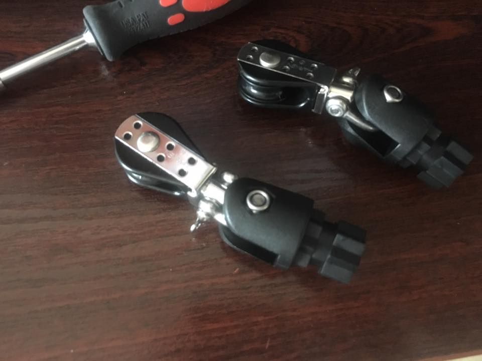

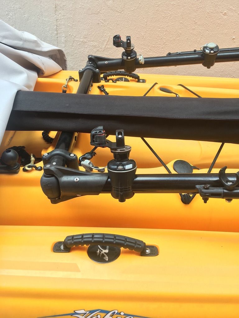

Here is the rest of the mods :)

Very tidy setup, thanks for sharing the photos. There are cheaper options out there but your railblaza setup looks very professional.

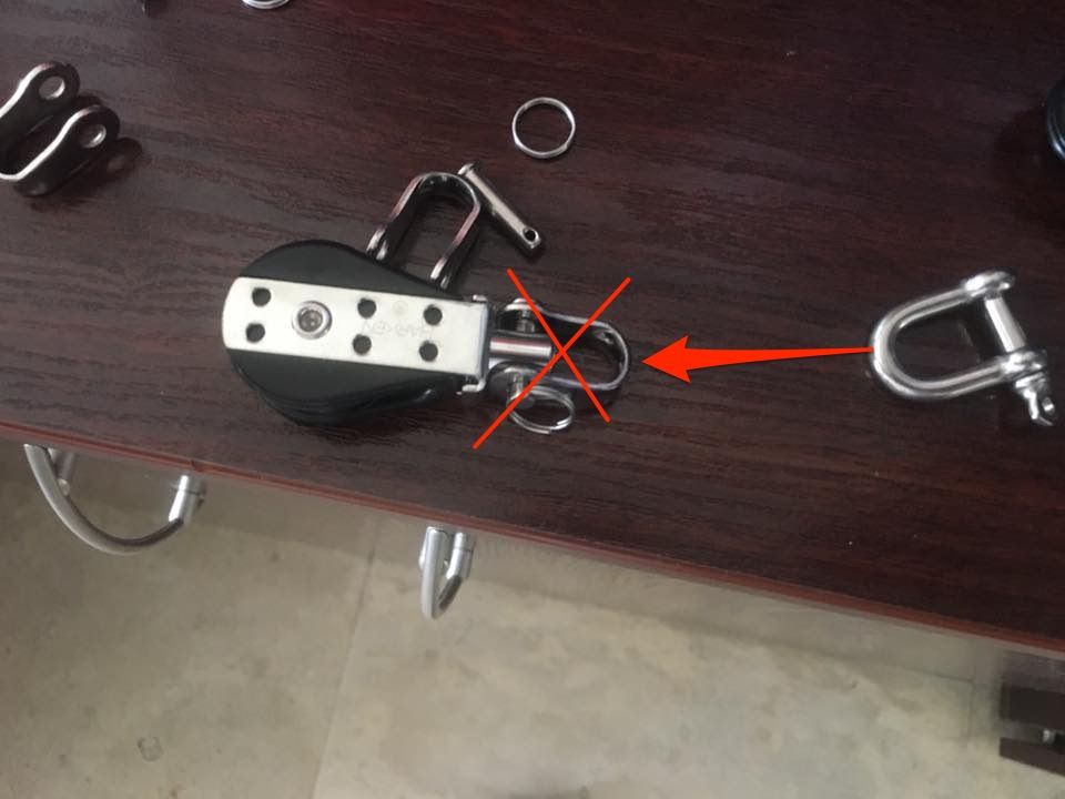

Very nice, but awfully expensive with those big sheave blocks and attachments. Bullet blocks will work fine for the wimpy loads you will see. Blocks can be tied to the frame with line-if you want neat, make a continuous loop splice around the aka. The half twist shackle is a good idea and Hobie should change the part in their kit.
