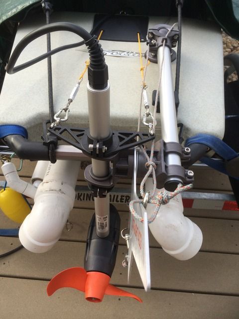

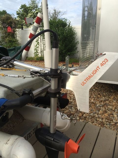

Finally found the time to get this project underway when someone with long arms came to visit. It is mounted and got out this week for its first test run. I'm very pleased the performance. I'm certain if someone saw me on the pond for the first time with this they would have thought I was drunk. I was all over the place, I should have taken a pic of the GPS mapping on my fishfinder. It looked like a plate of spaghetti. Too much fun.
Thanks again to all those who jumped in to help and guided me along the way.
Tied the rudder lines into the steering drum. Next time out I want to try it in the fixed position to compare.
Tight lines.

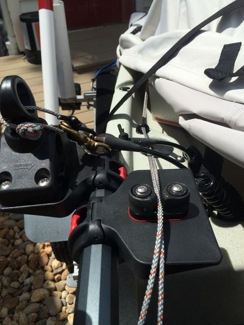

Can someone show me a photo of how you mounted a ram mount to the bottom of the throttle control? For now I have it mounted to one of my H-rail plates.

I velcro mine to the floor next to my seat. Keeps it out of the way and very easy to remove.
This is how I mounted mine. The advantage of the H-rail mounts is that they can be on the outside of the boat out of the way.
I also decided to mount a Harken cleat on the opposite side for the store and reverse lines for the Torqeedo. Life is a work in progress as is my Hobie.
