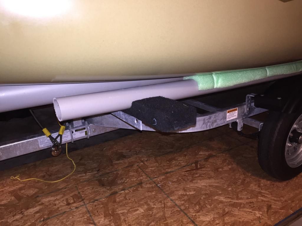

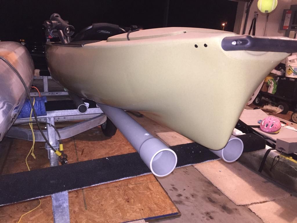

Here are some pics of how I set up my kayak trailer. 1 set of 3" schedule 40 PVC and 1 set of 2" notched to go over the wood bunk for extra hull support.

Thanks for the detailed images

You're welcome, glad to share. I have 8 bolts/screws in the 3" pvc and the notched 2" seems to fit snug enough not to need any hardware.
