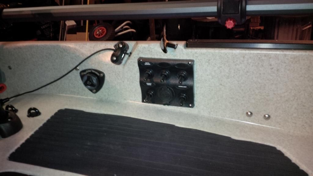

I decided to add a switch panel to my PA. I'm going to wire a stern light and some cockpit lights. I swapped out the accessory socket for a USB socket to charge my iPad mini.

man i have a panel but just can't bring myself to cut into it yet. looks great tho, what all do you run off of it and what size battery you use to push it all?

I wanted a switch panel but didn't really want to cut that large of a hole in my 8 month old PA14. Fortunately it was such a size that it fit almost perfectly into an existing hole. I removed one of the forward horizontal rod holders and put the switch panel in its place. I had to square off the hole a little bit but it as otherwise perfect fit. I rarely used both of the rod tubes, and if I ever get tired of thee switch panel I can remove and slide the tubes right back in.
The switch panel came with 4 switches, accessory plug and volt-meter. I replaced the accessory plug much like you did with usb plugs. If I can figure out how to post pictures, I'll post one of the install.

There will be a stern light, LED cockpit lighting (under mounting boards), Vexilar Sonar Phone and USB is for iPad mini. I will use a 12V 9ah battery. I will have a couple extra switches for and future add-ons.

Kansas Yaker, where did you order your switch panel from? Like the way it fits the space. Is there a cover for the USB port and is the panel waterproof.

I bought them both from Amazon. The switch panel came with an accessory plug that I replaced with the USB outlets. Yes, there is a cover for the USB. It is kind of folded up in my pictures.
Amarine Switch Panel - Says it is currently unavailable on Amazon. I'm sure you can find it somewhere perhaps ebay or maybe a marine dealer online.

Very clean install.
