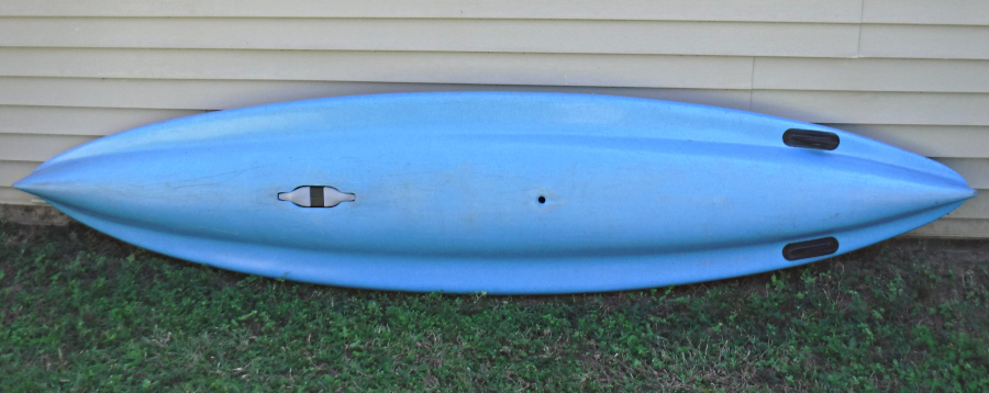

I just thought I'd post a couple pics of my early Mirage Classic that I put the fins on with the flaming / VHB technique outlined by stringy. They've been on there for months, used in estuary environments, mostly and are rock solid. They do seem to help with weather-cocking, although with some of the crosscurrents I encounter, there's only so much I can expect.
