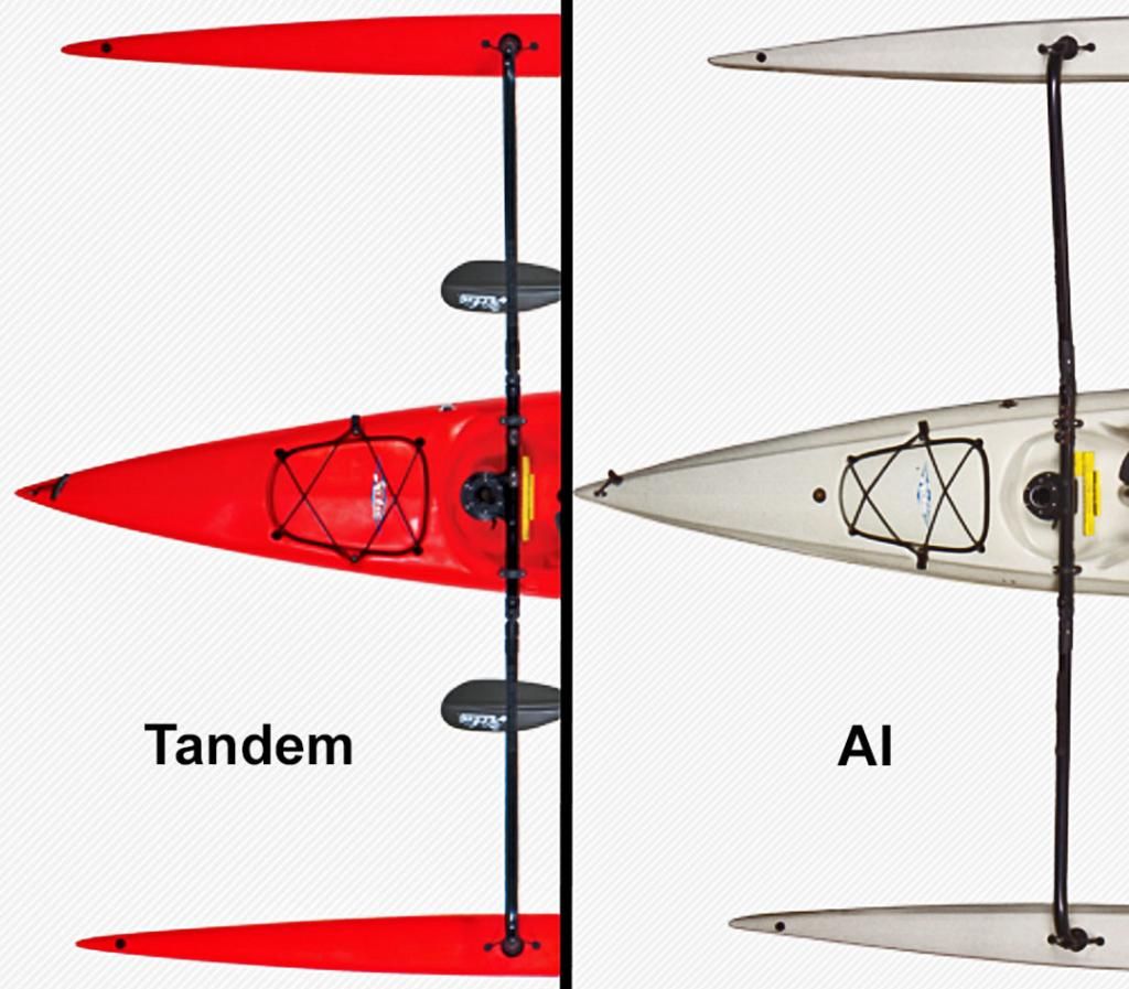

I certainly can't argue with anything you say Stringy. I just went in the garage and tried to make my 2011 AI bow flex like you did with your TI. Didn't happen, i.e., my AI bow did not flex when I put my full weight(185 lb) in front of the front hatch opening. For whatever the reason, the Tandem just does not seem as strong in the hatch area.
Here is a side by side picture of the two bows taken from the Hobie site today, Dec 12, 2014. The Tandem is not quite as clear—perhaps deliberately on Hobie’s part—but, the AI looks wider.
It is interesting that amas of the AI do not reach forward as much as on the pictured TI. The AI also seems as least as “full” in the bow area as the TI. Presumably this will lead to a dryer ride for the 2015 AI compared to previous models.
If the 2015 AI exhibits oil canning in the hatch area, I am going to immediately reinforce the area. You said this was an option:

As the Hobie pics have been Photoshopped, I'm not sure how much we can make of them, but that raised/ridged bow deck area would add to the strength of the new AI and make it a drier ride. As I said I think the TI's greater flexing is due to its larger area with no additional reinforcing. I can walk on the bow deck on my AI but not on the TI ...it collapses.
Hopefully the new model will have improvements in this area?
