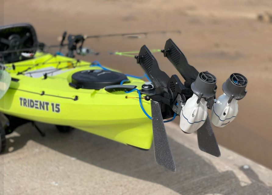

If you want to get really carried away you can do something like the below. Unfortunately I could not link the video, but this thing goes scary fast.

I don't think that specific dual-motor arrangement would work on a TI due to the TI's rudder, but other Bixby installations might work.
As far as scary fast goes, the TI can never achieve that, lol. It can only go just so fast before it begins to plow excessively, requiring exponentially more power to overcome. It was not designed to be a powerboat. It has no ability on its own to plane like a powerboat hull, so it will always be a displacement hull boat. 2.5 to 3HP can effectively get the TI to about 7-8 MPH maximum where it just about peaks in terms of hull capability. Fusioneng was able to go faster with twin Honda gas outboards, but his hull was significantly enhanced far beyond what any ordinary TI owner would likely do. Going much faster with an ordinary TI would require significantly more power and even then, the hull would plow so badly that it would not be practical or comfortable. Too much HP can also potentially damage the hull. So 7-8 MPH is probably a practical maximum for a TI. If you need to motor faster than that, you own the wrong boat, a powerboat is far more practical. If you want scary fast get a 300 HP PWC, they go around 70 MPH. I have one, so I know. Now that's scary fast.
So, for most people, the TI's maximum practical motored speed will be about 7-8 MPH stock. Around 5 MPH will be the nominal sustained speed for these motors, you don't want to always run them full thottle. You don't need a complex dual-motor setup to do that. Just one Suzuki 2.5HP gas outboard or a 3HP Torqeedo 1103AC will get you there.

Agreed with most of your post. When I said scary fast, I meant for that boat. Which I think clocked in at a max 12 mph.
However the main purpose I showed the pic was to illustrate just one of the many rear mounting options, Bixpy have something that will fit pretty much any kayak.
The TI is not just any kayak, that's the problem with mounting a motor to it.
Do you know of any Bixpy mounts that would specifically work on a TI? I think a lot of people here would like to see that, including myself. We have little interest in conventional Kayak motor mounts because they simply won't work on a TI/AI. So it's pretty much useless showing those types of mounts here.
The issue with the TI is its rear-mounted rudder. Most paddle-driven kayaks don't use a rudder and can use conventional bracket motor mounts. Hobie uses rudders because of the pedal drive and can't use conventional brackets. The TI's rudder is large and gets in the way of rear mounting a motor. Torqeedo's shaft-mounted motor mount was a great solution as it places the motor in the back of the rudder. It's still available as an option but they've now moved on to a conventional bracket mount which presents problems for the TI/AI and has only yet been able to be side-mounted which is a compromise.
The only way to mount a Bixpy J-2 to a TI/AI, of which I'm aware, is to use the Mirage pedal-drive hole. This has a lot of issues as I mentioned earlier. You lose the use of the pedal drive, the motor is highly vulnerable to damage being under the hull with no way to quickly raise it, and the hull will interfere with the prop wash causing a loss of efficiency and usable power.
So, in my opinion, the best motor mount for the TI is still the Torqeedo Ball Mount because it can be center mounted in back of the TI's rudder.
That gives it maximum efficiency. It has no side torque induced power loss as with a side-mounted motor, no power loss from interference to the prop-wash as with a side or under-hull mounted motor, and no shallow water vulnerability as with an under-hull mounted motor. With very low-powered motors (1-3HP), you don't want to lose any power due to inefficiencies if at all avoidable.
I don't feel the Bixby is a viable option for the TI/AI until a suitable TI/AI mount for it is developed, tested, and proven either by Bixby or a third party. It's too underpowered for side mounting and under-hull mounting is simply a bad idea.
Yes there's several of them, and even mounts that clip directly onto the rudder.
Essentially if you can mount a Torqeedo, you can just as easily mount a Bixpy.
